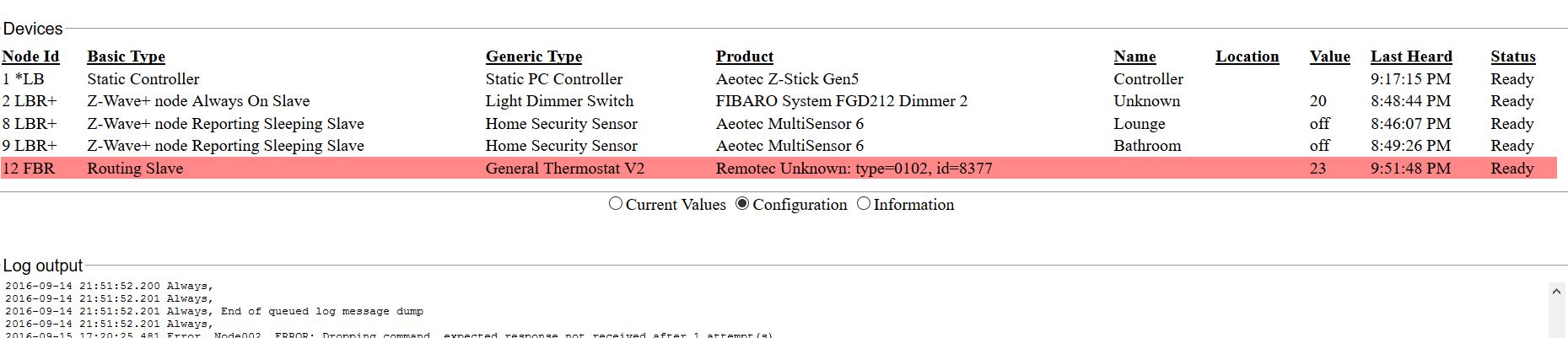

Having a bit more of a play with this and looking at the config files on the Raspberry Pi.
The ZXT-120 is reporting a type of 0102 and ID 8377. I assume that is compared against the manufacture_specific.xml file which links Domoticz to the correct config file?
My product ID is 0102, where the ID in the manufactures_specific is 0101. Guessing again is it likely the 0102 Id is the Au/Nz product and I could alter the xml file as below to link to the same config?
<Product name="ZXT-120" id="8377" config="remotec/zxt-120.xml" type="0101"/>
<Product name="ZXT-120" id="8377" config="remotec/zxt-120.xml" type="0102"/>

Re: Remotec ZXT-120
I figured I would just try it, and I now have config options and can move forward on getting this setup again.
I case it helps anyone else I found the manufactures_specific.xml in /home/pi/domoticz/Config using bitvise SFTP I edited it using the default editor bitvise links to.
Learnt a fair bit more about linux, SSH and Z-wave too.
