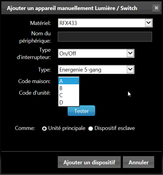

I have bought a Etekcity Smart Wireless Electrical Outlet from amazon.ca (https://www.amazon.ca/Etekcity-Wireless ... cal+Outlet)
i try to control it from domoticz through Rfrxtrx433,
In RFXmngr, i can turn on and off the outlet (housecode=H, unitcode=1-3)
By can't add it as dimmer to domoticz, only housecodes A to D are available for Energenie 5-gang ?
Lighting1 command
Packettype = Lighting1
subtype = Energenie 5-gang, Etekcity
Sequence nbr = 3
housecode = H
unitcode = 3
Command = Off
Signal level = 0 -120dBm
is there a way to get it work in domoticz ?
- 2016-09-14 07_29_45-Domoticz - Internet Explorer.png (21.08 KiB) Viewed 2344 times
