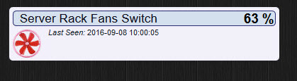

I updated to the latest Beta version of Domoticz last night and now my Smartswitch is show a "percentage" value on the Dashboard when it's on. Has anyone experienced this and what does it represent exactly?
thanks

When exactly did you update? I see a change (from yesterday) on github that might have caused this, but it was reverted late last night. So depending on when you updated it might work like it used to if you update again.

ahhh ok! literally did it last night about 10pm. If I download the latest beta and then run again?

Yeah just get the latest beta, judging from this thread: viewtopic.php?f=6&t=13235 , it was a little after ten.

Perfect, did that and a reboot and it was sorted. Thanks :)
