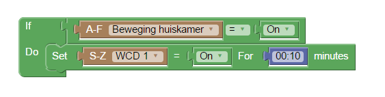

Hi everybody, I have a simple question, simple for you probably, but frustrating for me. I tried to make a blocky script, the most most easy ones succeed, but when I change one tiny bit (you got to get started somewhere), the lights stay out.
2016-08-22 17_41_57-Domoticz.png (8.58 KiB) Viewed 1091 times
Can somebody help me please, what am I doing wrong? or is there a download somewhere..., with a small explanation...?
Thanks mate,
Jan

Maybe: If "Bewegung***= Motion ??

Jep, beweging is motion, sorry jkimmel.

Hi, Just use an integer block not a time block for the 10 Minutes.
