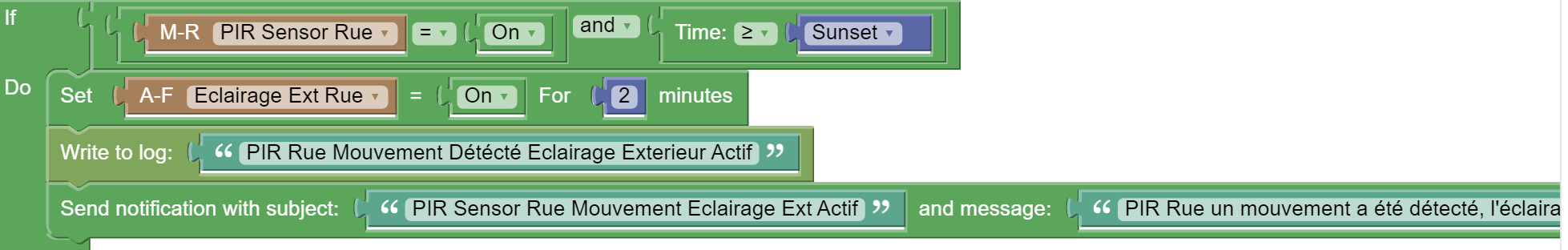

i tried to use the blocky events to turn on the lights when there is motion with my pir, it only trigger when the sun sets and the lights turn on for 2 minutes.
it doesn't work even if i add the symbol <,>,= after the variable sunset. i think the problem is here.
The result is my lights is always turn on.
Any idea how i can fix this ?
thanks for your help

Finally i did this !
