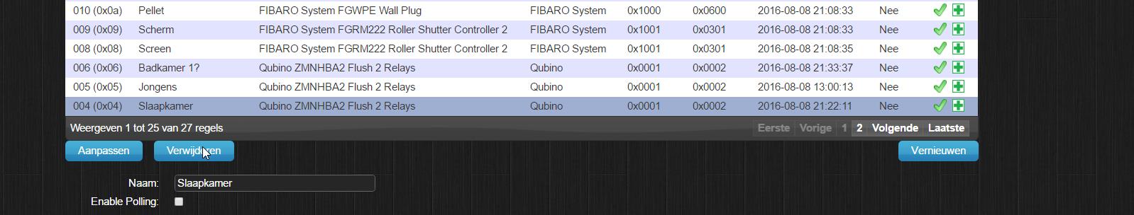

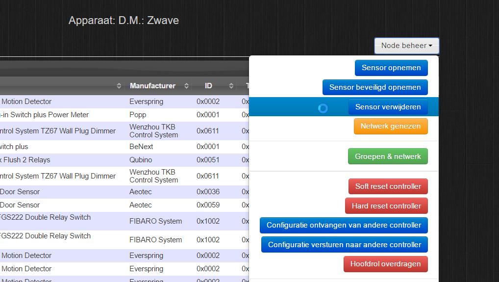

Derik
Posts: 1605
Re: How to remove dead Z-Wave nodes?
Post by Derik »
Perhaps:
Or stop domoticz
Search for the Zwcfg.xx file...
And search the dead node.
Remove all the dead mode confif settings correct [ remove al the text ]
Restart domoticz
And remove the node:
And restart Domoticz
