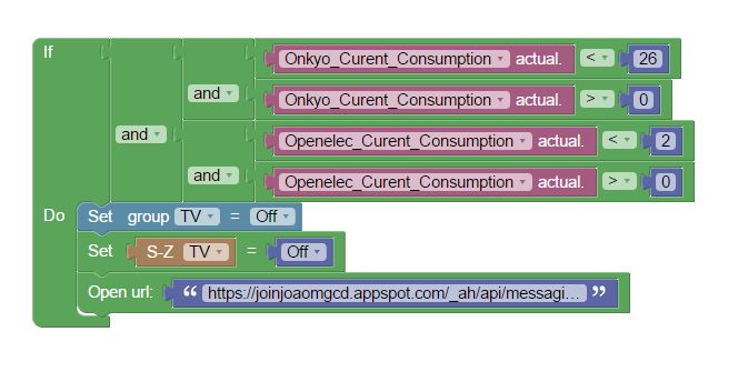

I have some problems with a blocky that worked fine.
2016-07-31 15:11:53.588 (RaZberry) Usage (Computer_Curent_Consumption)
2016-07-31 15:11:53.611 (RaZberry) General/kWh (Computer_Tota_Consumption)
2016-07-31 15:11:55.087 (RaZberry) Usage (Computer_Curent_Consumption)
2016-07-31 15:11:55.109 (RaZberry) General/kWh (Computer_Tota_Consumption)
2016-07-31 15:12:05.587 (RaZberry) Usage (Computer_Curent_Consumption)
2016-07-31 15:12:05.609 (RaZberry) General/kWh (Computer_Tota_Consumption)
2016-07-31 15:12:13.089 (RaZberry) Usage (Computer_Curent_Consumption)
2016-07-31 15:12:13.125 (RaZberry) General/kWh (Computer_Tota_Consumption)
when I check Show current states it shows me
	Onkyo_Curent_Consumption	0.0	2016-07-31 08:54:47	0.0
	Openelec_Curent_Consumption	0.0	2016-07-31 08:54:47	0.0
if I go to the OpenZWave Control Panel and run a refresh on the device the switches get turned off.

I noticed if I enable polling it works too but that values get reseted after some time

Auto healing network caused the problem
