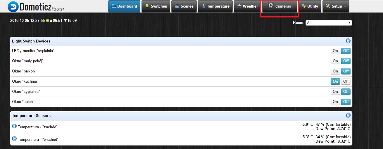

It should looks as on screen:

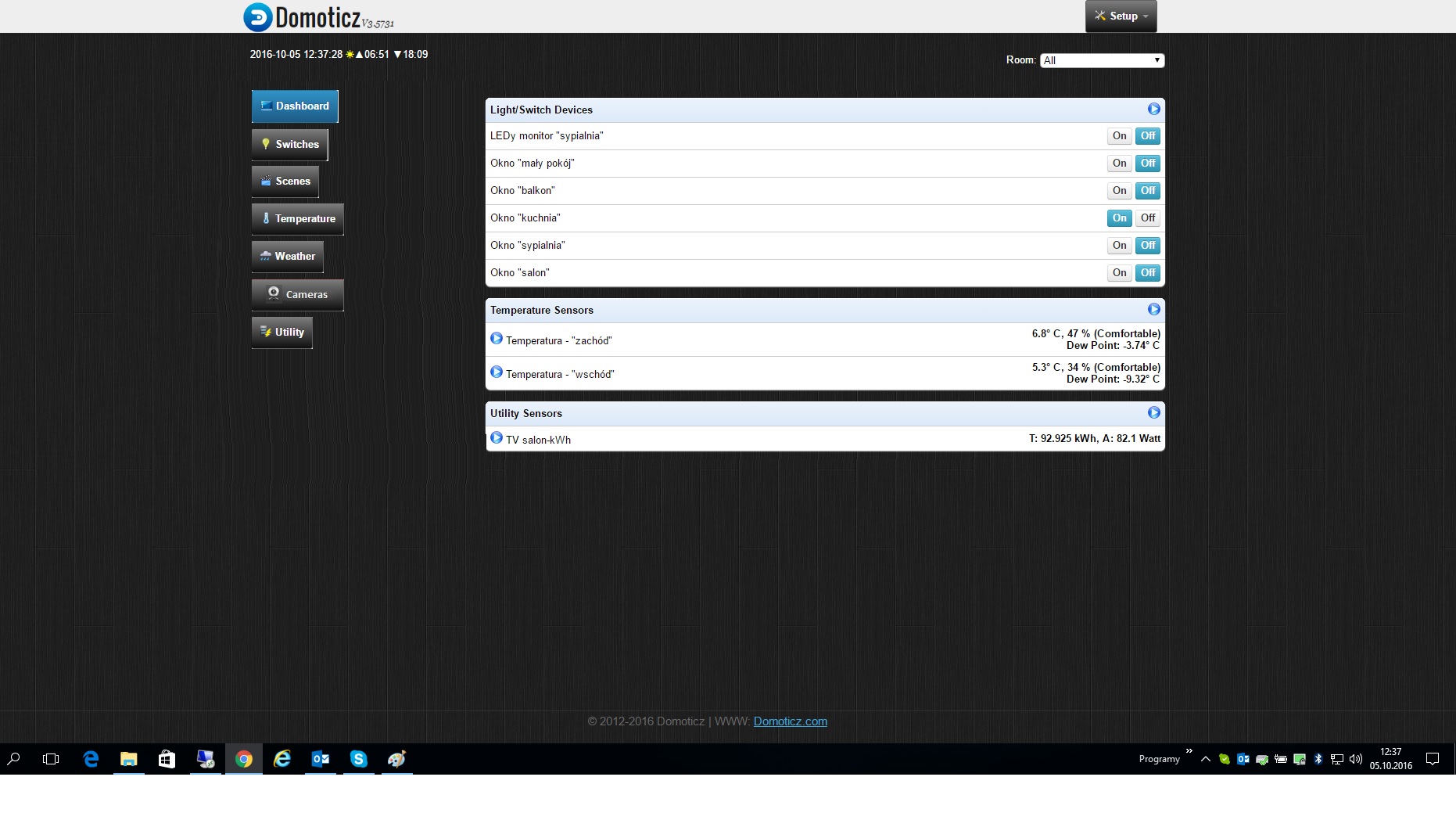

I also think that menu with tabs should be move on the left page because in some languages this menu on top page is to big. On top page should only be tabs/icon for open menu setup Menu on the top page is limited in size to add new tabs.
I think to look as and set size button tabs to the same size(on screen is other size for each):

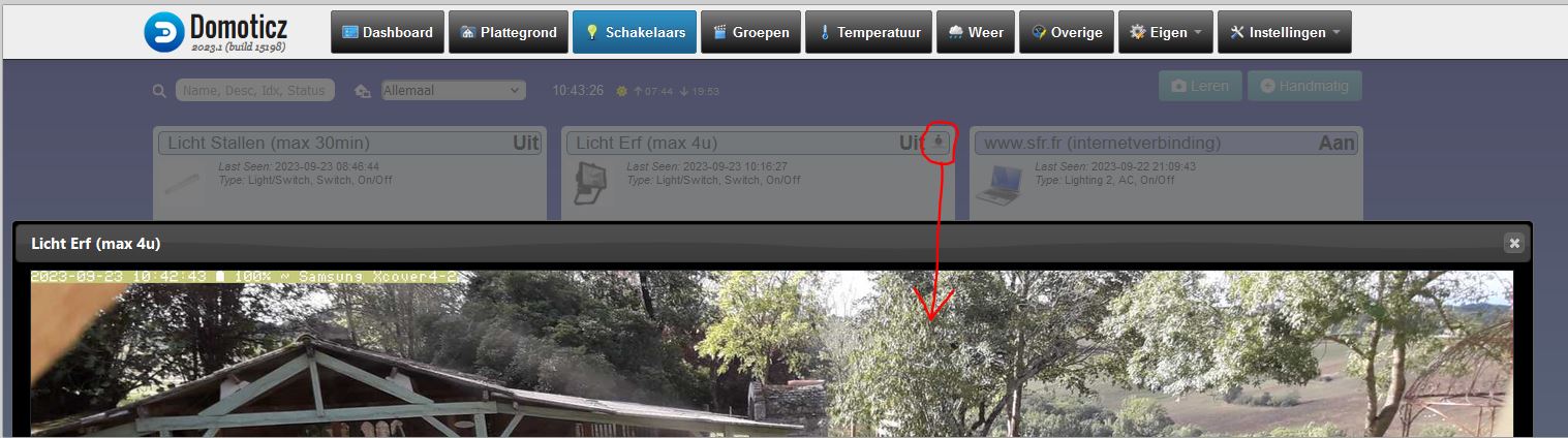

Too bad nobody of the Domoticz team really responded to this topic! Personally I think in this time/age with cameras everywhere, Domoticz clearly gets behind in adapting to cam views in its layout. The only thing you can have is a small icon added to a scene (in tab 'groups') or to switches (and with some luck switches on dashboard), if there is some logic between that ???

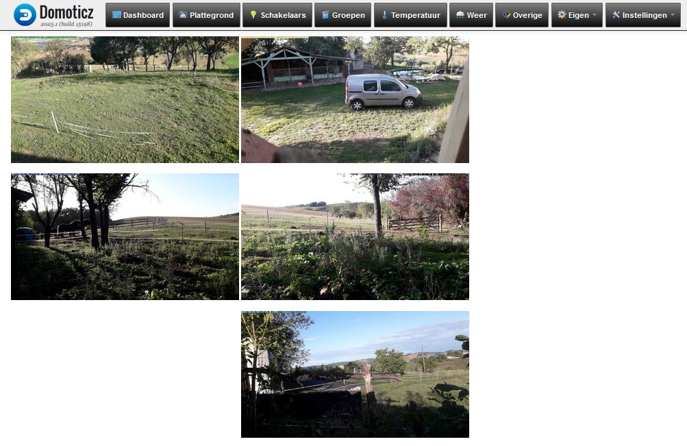

Then, if you click on a particular cam-icon from a switch/scene the popup overlaps the entire screen, can not be resized and blocks all operations until cancelled. This is so backward, that it inspired me too to create my own html page in templates. It takes screenshots per cam (not live streams cause that is very network/cpu intense), and overwrites every 5 seconds by means of a javascript cause "<meta refresh>" in an iframe, or not, produces these awfull white flashes. Below is an example and below that the html/java-script I'm using.
For the Domoticz development team I hope new versions will implement cams better then uptill now!!!
my own version of cam views
Domoticz showing multiple phonecams.JPG (120.01 KiB) Viewed 5485 times
and here's what I mean adding a cam from a scene to a switch but launching the view overlays entire tab while resizing is blocked, WHY ???
no resize possible, overlaying entire tab :-(

=>>> HTML code of the page I added to domoticz/templates/all_cams.html is available,
=>>> for those interested send me a personal message and I'll send you the html file (bit too tall for inside this box!)
