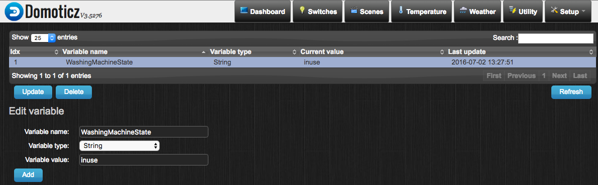

It uses a user variable which you will need to manually create prior to running the script, see below screenshot.
