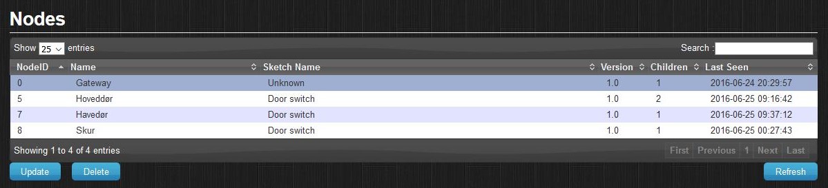

Hi all
I posted this first in the MySensors forum, but was advised to post here.
For background information, I use the latest v.2 beta version of MySensors, and latest development version of Domoticz. The 3 nodes that I have are 100% identical, both HW and SW. I use a serial gateway based on the RFM69 radio.
Here is the situation - when I add my 3 identical Door Switches, they are created randomly with either 1 or 2 children. All children are created with a child ID of 0 (S_LOCK ). But some of them are also created with a child ID of 255 (S_ARDUINO_NODE ).
What is the normal behaviour – 1 or 2 children created?
Below is how I do the presentation. Is there anything wrong here, should I reverse the presentation so I send the sketch info before the present? Or should there be some 'delays' to give Domoticz time to create the nodes?
void presentation() {
  present(CHILD_ID, S_LOCK);
  sendSketchInfo("Door switch", "1.0");
This is my 3 Nodes:
Here the node are created with only 1 Child:
Here are a similar node created with 2 Children:
Best regards
Lemme

It seems that things are partly begin to work correctly. I found out that all examples had 'sendSketchInfo' first. I also found delays in one of the examples, and I implemented that as well. This is how it looks like now:
  wait(500);
  wait(500);
I also updated MySensors library, there were som TransportProcess cleanup yesterday, and it seems that some of those changes included some changes to the presentation as well.
All nodes are now created with only 1 child of 0. So I must conclude that creating child_id of 255 is wrong.

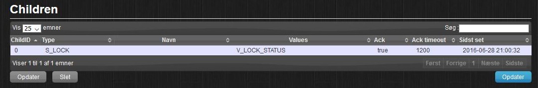

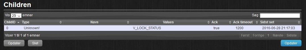

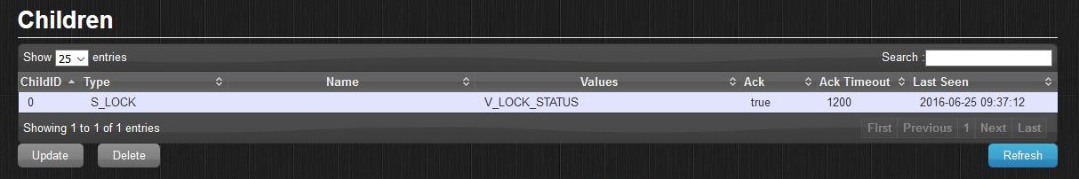

As this seems to work now, there are now another problem. Only one of the nodes are identified correctly as an S_LOCK node. The variable V_LOCK_STATUS are identified correctly on all nodes.
All nodes now have 1 child:
This node have both S_LOCK node the variable V_LOCK_STATUS identified correctly
The remaining nodes are missing the S_LOCK, but the variable V_LOCK_STATUS identified correctly
Any clue why this is happening?

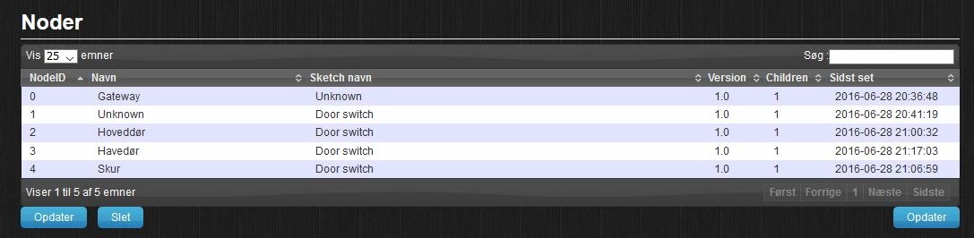

I have now done a bunch of tests with virtual nodes as you suggested. And you are right, it makes no difference what comes first.
That leaves me to the conclusion that the issue is with the v.2 development version of MySensors. I did some testing last night with the stable 1.5.4 version, and here all the nodes were created correctely.
It could be that when the MySensors v.2.0 are released, there will be some adjustments to Domoticz.
Best regards
Lemme
