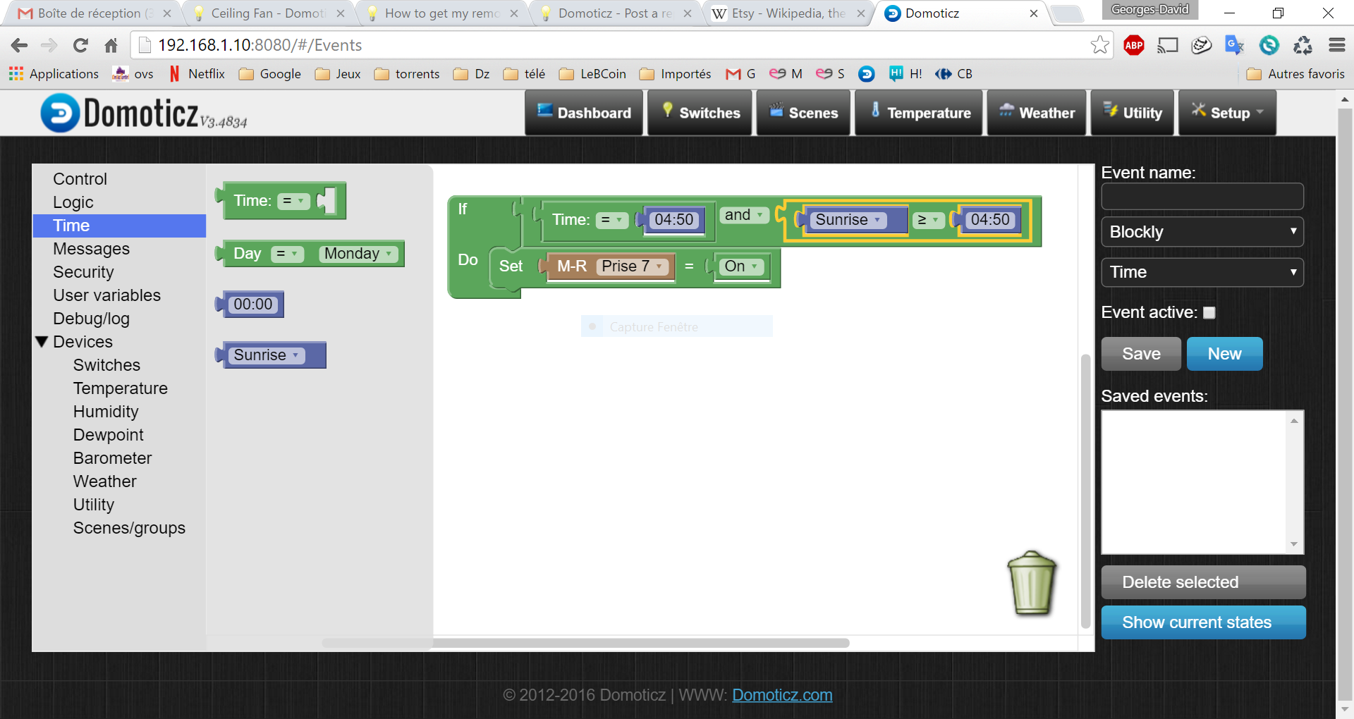

maybe, there is what you need in blockly, especially if you click on Time, you will get several options with sunrise and times, and so on.
With this, the switch "Prise 7" (an example here) should turn on at 04:50, but only when sunrise occurs after 04:50.
You also have to remove the timer "Turn on 04:50 in the morning" (it is replaced by this block),
but keep the timer "Turn off at Sunrise".
don't forget to click "Event active", as I often do.
I'm sorry I couldn't test it, so you have to do it
Regards,
GD

That didn't work
The Blocky script generates errors in the logg

Hello Jonas,
sorry not to have answered sooner, I was away for my work.
you are right, Blockly doesn't like "Sunrise" on the left so, this new block worth a try.
I think it equivalent to the previous one.
As I cannot do an image attachment, I will explain in text :
instead of : "Sunrise >= 04:50"
one must use : "Time >= Sunrise"
See you, tell me if u want more.
GD
GD
