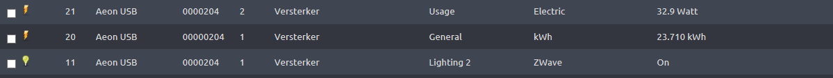

Re: Greenwave Powernode Total usage
Thanks for the answer. I do not see a device with the subtype kWh. I have seen it before, but I installed everything again and now I don't see it anymore... Below the items I see. You can see that I have usage twice, but no kwh...
That's really strange...
I think over time the one with ID 12 will display kWh.
I have a similar set of entries for one of my power nodes: However, I have added two new power nodes and they don't show up with the kWh item either: In general if you don't see kWh patience and a reboot of the Domoticz system is a good practice. But I am in doubt if perhaps the NS112-F that I have added now just don't support kWh
