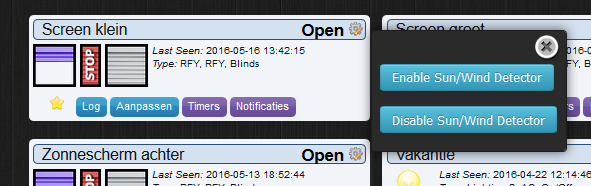

I have screens from SOMFY with the Sun/wind detector, working in Domoticz.
I like additional control time schedule.
For example, the screens may only be controlled by sun/wind detector when it is a working day and started by 9 o'clock.
Is there a command to use "Enable sun/wind detector" in LUA or Blockly events?

Re: Somfy screens with SUN/Wind on time schedule
Iḿ trying to make a group or a switch to controll the commands to turn the screen in sun/wind modus of manual modus. i tried it with this command:
http://192.168.1.55:1720/json.htm?type= ... SunWind(1)"
http://192.168.1.55:1720/json.htm?type= ... SunWind(0)"
But it does not sent the "RFYEnableSunWind(1)" or the "RFYEnableSunWind(0)" command. it seems that its sending only the open or close command. Is there a way to sent the "RFYEnableSunWind(1)" and "RFYEnableSunWind(1)" commands to my screens ? (without using the popup menu, so i can create a virtual button, wich i can use in scripts or with blockly)
Hope im clear.
WIth a lot of help form Marko; problem solved!
the commands are:
http://192.168.1.55:1720/json.htm?type= ... bleSunWind
just replace your ip and the idx number compare to your screen and use these http lines in a virtual switch (it didnt work in a group)
Floris

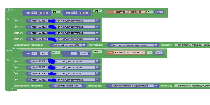

Hai
with the help of Floris74 answers i could managed to combine a time schedule and the Wind/SUN sensor on my screens (4x).
I created a dummy switch to set on/off the Automatic for the screens and combined it with the time schedule.
I have to expand the blocky with the days, but thats piece of cake
Thanx and up to the next project
A little failure in my blocky code.
It wants to set every minute the code on for the sun/wind sensor on the screens.
Has someone idea how to correct this.
Rutger
