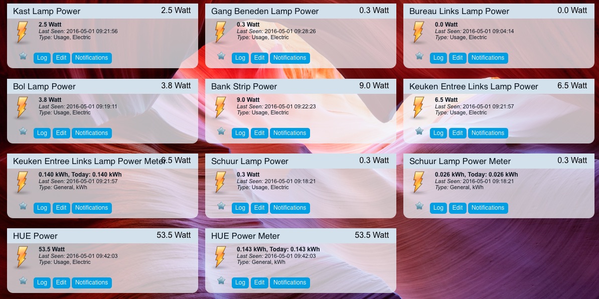

This is my script for adding virtual Usage and Energy sensors for philips hue lamps and fixing the simple update script ...
This is an approximation in no way are these the real values, there are no sensors on the HUE bulbs and strips. What this script does is using a lookup table which contains readings of the power usage corresponding to the brightness of the HUE light.
Update: with hue remote dimmer switch support see: http://domoticz.com/forum/viewtopic.php ... 418#p85418
Screen Shot 2016-05-01 at 09.42.09.jpg (237.27 KiB) Viewed 13675 times
I used the simple update script for hue as basis... work in progress... Currently thinks all lamps are white bulbs since i did not tried a colored one... but can easily be adjusted buy detecting the right bulb (from the hue json).. Also the reading are done with my powernode 1 probably not that accurate... but this is all approximations anyway... I just wanted to know how much energy the lamp will cost me ;-)

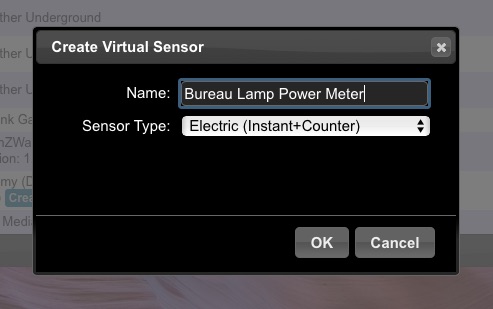

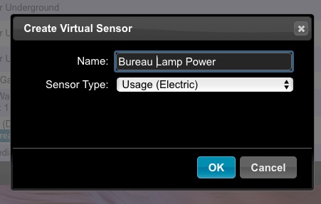

    :!: If your HUE Lamp is called "Bureau Lamp" you will need to add new virtual sensors "Bureau Lamp Power" & "Bureau Lamp Power Meter". Do this for all your lights
    Screen Shot 2016-05-01 at 09.31.37.jpg (35.12 KiB) Viewed 13679 times
    Screen Shot 2016-05-01 at 09.31.28.jpg (32.86 KiB) Viewed 13679 times

I get the following error:
2018-05-31 15:57:16.803 Error: EventSystem: in hue_status_update_2.lua: [string "-- TRiXWood May 2016 ..."]:52: bad argument #1 to 'sub' (string expected, got nil)
Line 52:
 year = string.sub(s, 1, 4)
Any clue how to solve this?
Re: HUE Power Usage & Energy Script
Posted: Sunday 23 September 2018 5:00
by phermn
Hi PaulM, I'm having the exact same problem! Did you ever manage to resolve this issue by any chance?
Posted: Saturday 17 November 2018 17:03
by jeroenvanpelt
phermn wrote: Sunday 23 September 2018 5:00 Hi PaulM, I'm having the exact same problem! Did you ever manage to resolve this issue by any chance?
Most likely you have not created a Power and a Power Meter virtual sensor for every Hue light that is in your Domoticz. The error is triggered when the code tries to add up power values for Hue lights assuming you have created "<Light name> Power" and "<Light name> Power Meter" virtual sensors for every single one.
