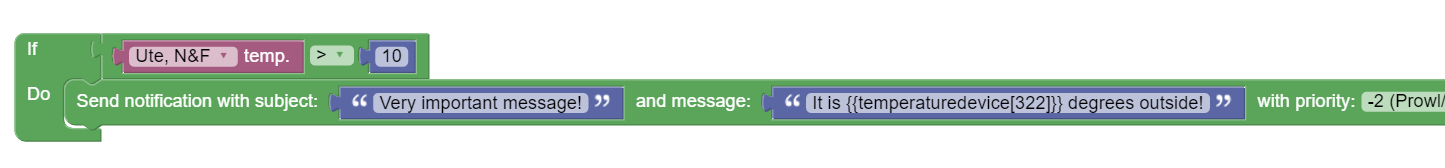

I'm not following you.
Just use the "Send notification with subject .." block and ignore the priority and sound setting as they don't apply to Join/Custom HTTP notification.
You have three "groups" of notifications. SMS, e-mail and notification services. Pushover and HTTP (in this case, Join) is two of them and one of them supports priority and sound to be set, the other one does not. In the Join case, as I said, just ignore the priority and sound setting in the block in blockly.

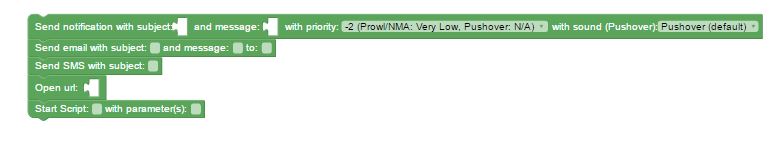

I never tested the first one as I thought it was for pushover only
Will it send a message to all notification services I have setup in the settings?
I have Kodi setup also.

Varazir wrote:blocky.JPG

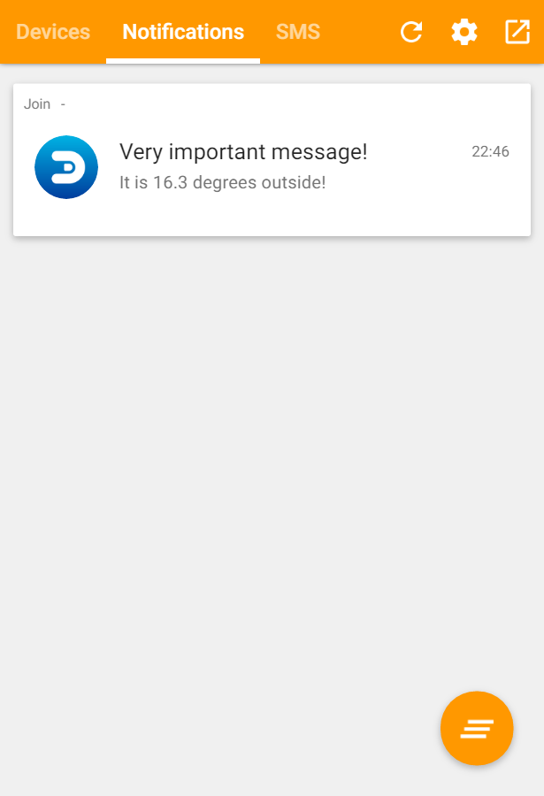

Yeah. The sound selection is only used with Pushover. For other services, it will be ignored.
All services (but HTTP I think) support the normal and high priority. The other ones are service specific (like -1 only used for Prowl/NMA and Pushover). The Join API does not have support for priority but I'm sure it's coming. Then Domoticz need to be able to set the priority in the called URL for custom notifications, dynamically setting something like #PRIORITY. For now, all notifications created by Join use the "high" priority.
Edit: Yes, to all enabled.
Send notification if the temperature outside is over 10 degrees c. ;)
