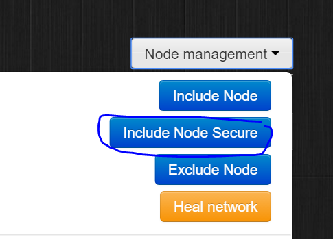

First i edited manufacturer_specific.xml under domoticz/Config and added the line: <Product type="0008" id="0002" name="Danalock Circle/Square" config="polycontrol/doorlock.xml"/>
Then i include the Danalock with include secure node.

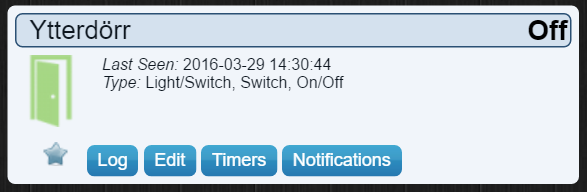

I didnt change the switch to a door lock because its inversed so i decided to go with regular light switch and upload a new icon template instead.

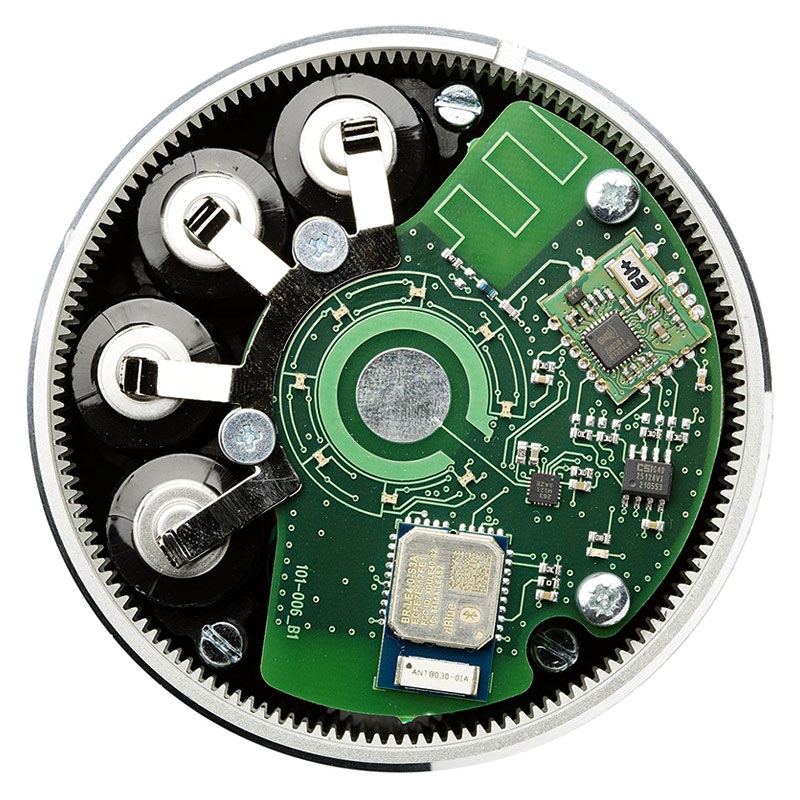

I got this from support
" Is your lock z-wave compatible? ( if you take the top lid off, there should be a letter E on a small chip)"
I think you have to have the square board with eu+ , see the image below.

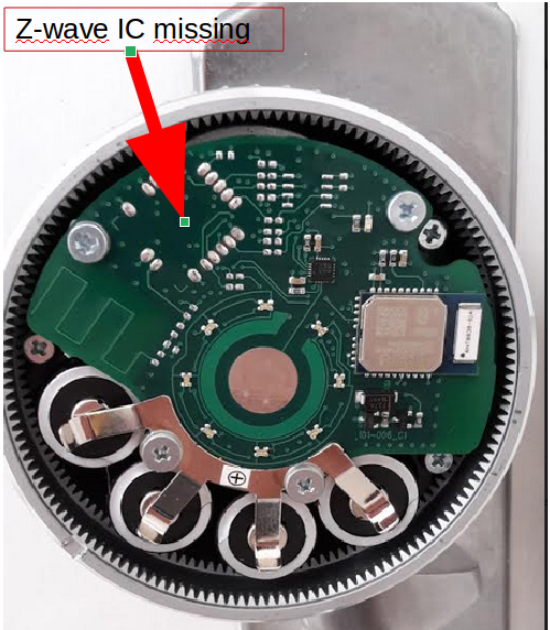

bjacobse
Posts: 85
Joined: Tuesday 06 September 2016 9:08
Location: Sorø, DK
Re: Danalock V2 Circle howto
Post by bjacobse »
Thank you once again Smedberg, now I understand why my Danalock V2 isn't working with Z-wave at all
Apparently the lock I bought in Bauhus.se is without Zwave and only BT:-(
