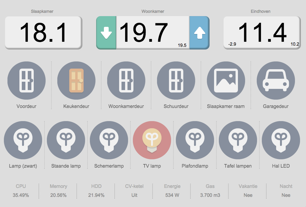

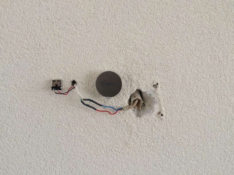

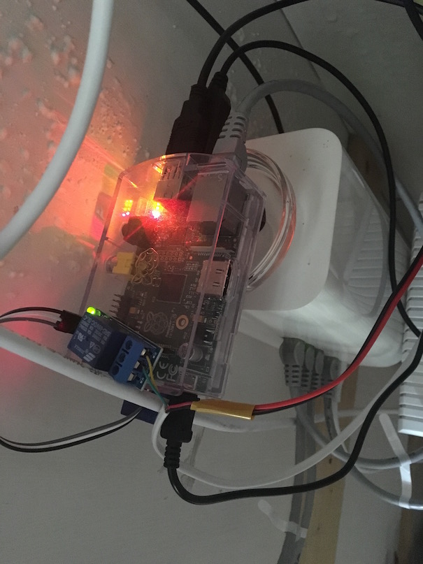

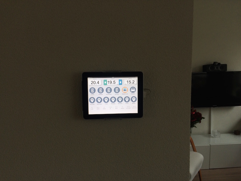

Hi guys,
Here is a peak into my home made Thermostat.
I have a heater that only has the on- and off option, that makes it easy to control.
I removed the old Honeywell thermostat and connected the wires to a relay and GPIO of the Raspberry Pi.
Than I used the hole in the wall to provide the iPad with power.
This is my script: https://github.com/kvanhoorn/domoticz/b ... ostate.lua
See the pictures for the hardware.
Dashboard on iPad
Dashboard on iPad
Hardware behind iPad
Hardware on RaspberryPi

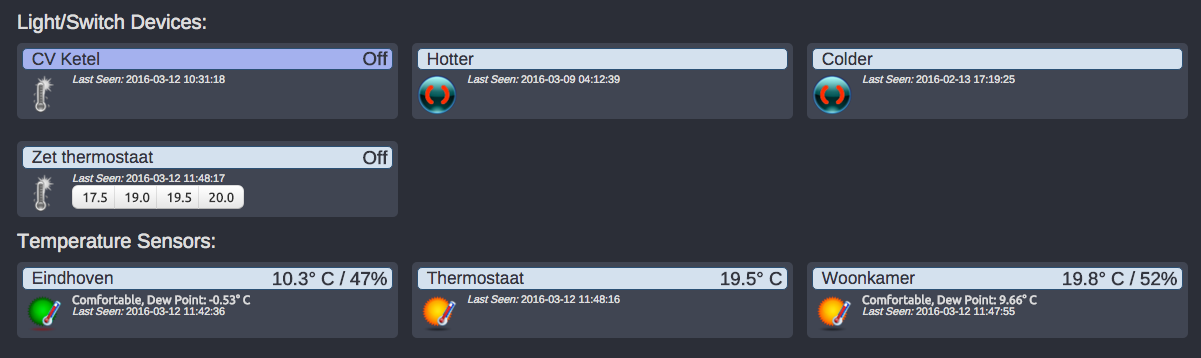

And here are two screenshots of the dashboard and the devices in Domoticz.
Screen Shot 2016-03-12 at 11.48.24.png (75.19 KiB) Viewed 2266 times
Screen Shot 2016-03-12 at 11.57.01.png (91.64 KiB) Viewed 2266 times
