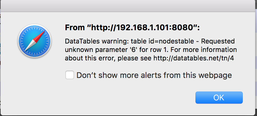

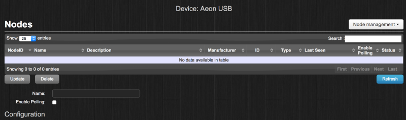

I installed an Aeon USB Stick Gen 5 on the raspberry pi 2, after having linked it to the Stick the Fibaro motion sensor. Domoticz firstly saw both the Aeon and Fibaro devices within the Aeon Stick setup page, but couldn't see the parameters (light, temperature and so) related to Fibaro device on devices page. After a domoticz upgrade the setup button on domoticz is red
Screen Shot 2016-03-05 at 08.35.21.png (260.53 KiB) Viewed 4484 times
and the device setup page is empty
I did stop and started again domoticz without solving this issue.
can anyone tell what should I do?

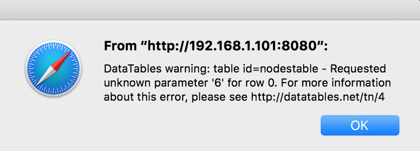

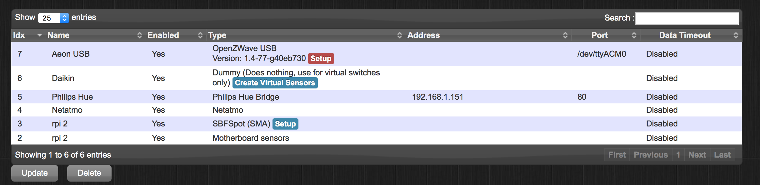

very strange, I rebooted the rpi (after system update) and now setup button in blue.
Screen Shot 2016-03-10 at 20.14.53.png (203.45 KiB) Viewed 4466 times
When I click on the setup button two pop-ups appear:
Screen Shot 2016-03-10 at 20.15.02.png (69.63 KiB) Viewed 4466 times
Screen Shot 2016-03-10 at 20.15.07.png (84.18 KiB) Viewed 4466 times

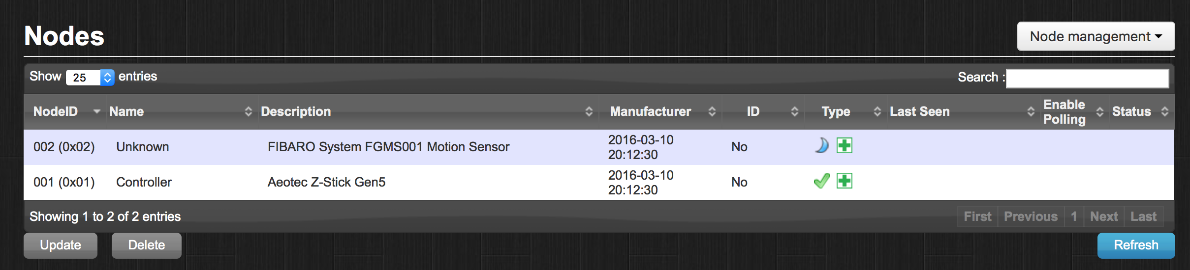

then I see the devices in the Aeon setup page:
Screen Shot 2016-03-10 at 20.15.12.png (286.85 KiB) Viewed 4465 times

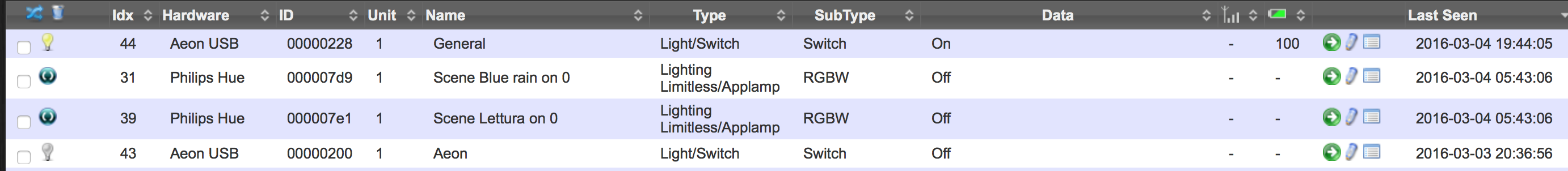

but couldn't see the Fibaro on the devices domoticz page. I see only two switches related to Aeon Stick
Screen Shot 2016-03-10 at 20.18.23.png (168.54 KiB) Viewed 4465 times
Re: cannot see z-wave devices
Posted: Thursday 10 March 2016 21:37
by StephaneG
Devices 43 and 44 are your fibaro's sensors (their ID's are 000002xxx, and 2 is the fibaro's node number).

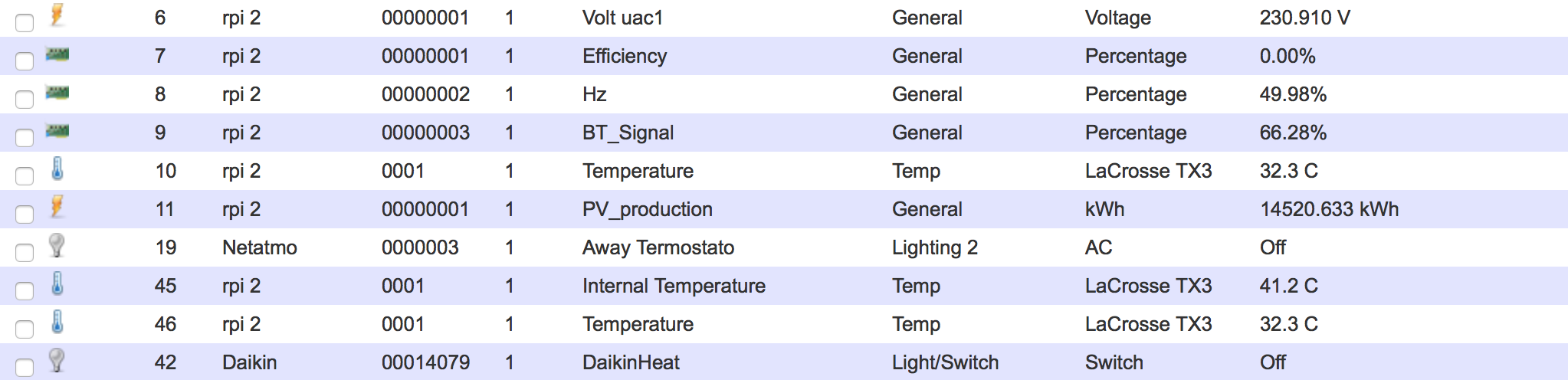

why fibaro sensor appear as two switches when it is a there-in-one sensor (motion, temperature and light)?
what should I do (apart click on green arrow)?
I also see some strange devices related to rpi2, could be from Fibaro sensor?
Screen Shot 2016-03-10 at 23.32.51.png (166.57 KiB) Viewed 4425 times
thanks
gabriele

course66 wrote:why fibaro sensor appear as two switches when it is a there-in-one sensor (motion, temperature and light)?

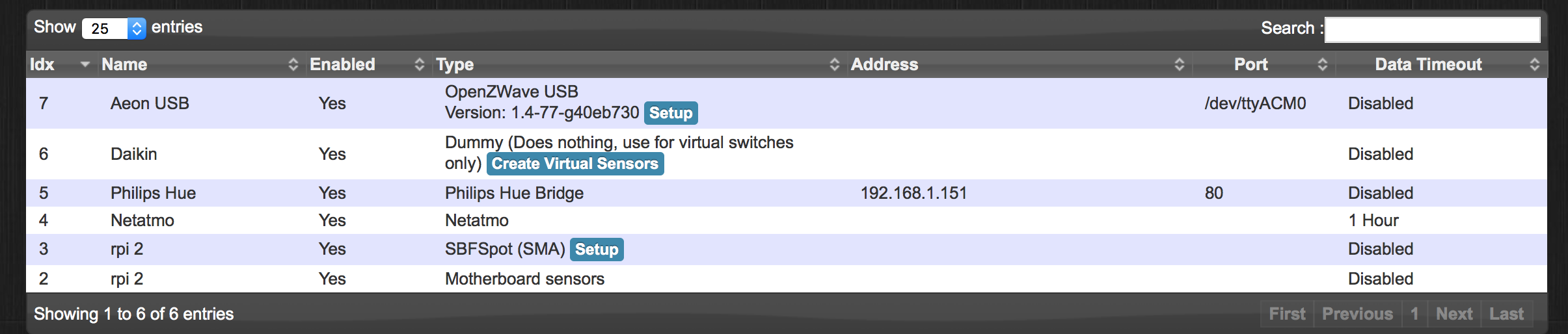

First follow the following guide so the ZWave stick will always have the same USB port number after reboot.
http://www.domoticz.com/wiki/PersistentUSBDevices
Second remove the 'SBFSpot' hardware in your hardware list. This gives the 'wrong' devices in your list.

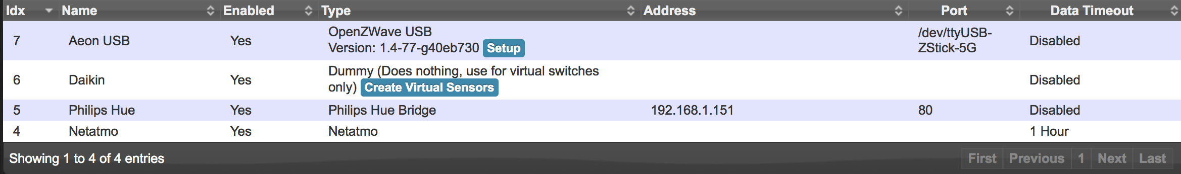

Hi bbqkees,
I removed Aeon, made Aeon persistent on usb, deleted SBFspot, re-booted, connected Aeon hardware to new USB port.
Screen Shot 2016-03-14 at 20.48.15.png (127.82 KiB) Viewed 4339 times
Screen Shot 2016-03-14 at 20.48.29.png (208.3 KiB) Viewed 4339 times
but...

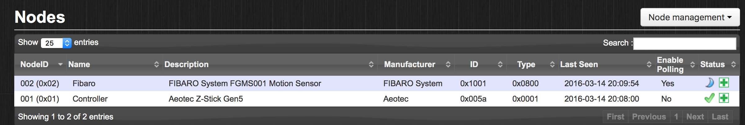

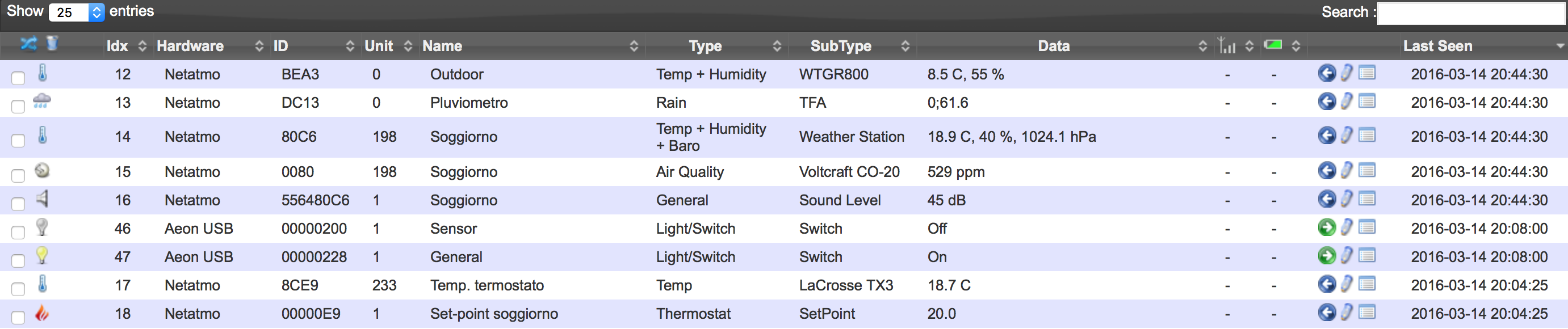

I still see only two switches
Screen Shot 2016-03-14 at 20.48.39.png (319.76 KiB) Viewed 4335 times
even if from the log it seems that domoticz+aeon can read other devices...
any idea?

Did you try to exclude and re-include the device?
Posted: Wednesday 16 March 2016 12:02
by Kroontje
Disable polling for the motion sensor, wake up the sensor by 3x clicking the include button and filter under Devices for Aeon or '00002' and see what shows up. The logging tells you that the Temperature and Luminance nodes are added. :)
