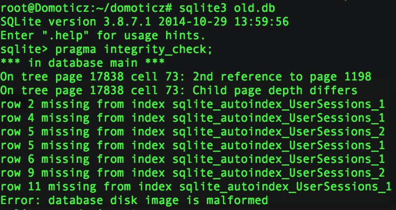

Separately if you want to check a database to see if it's corrupt you can use these commands:
sqlite3 domoticz.db
pragma integrity_check;
.exit
Output for the corrupt database in my case was:
Screen Shot 2016-11-19 at 5.21.50 pm.png (120.87 KiB) Viewed 45537 times

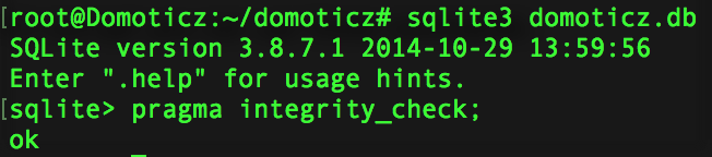

And for my new repaired database the output looks like this:
Screen Shot 2016-11-19 at 5.23.56 pm.png (39.93 KiB) Viewed 45537 times
