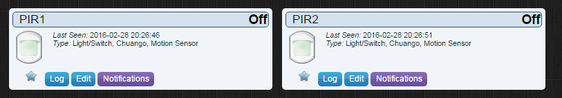

Dear Forum,
I have a few sensors which are configured to notify me (Pushbullit on iOS and email) and when certain things happen. I.e. PIR sensor notifies when motion is detected. This is currently configured under the Notification menu item on each PIR switch.
How can I easily disable the notifications, preferably with "one click"?
I have created a script which stops the MotionEye video surveillance software (sudo service motioneye stop) when I trigger a dummy switch, but have not figured out how to do this with notifications.
Any advise or guidance would be greatly appreciated.
