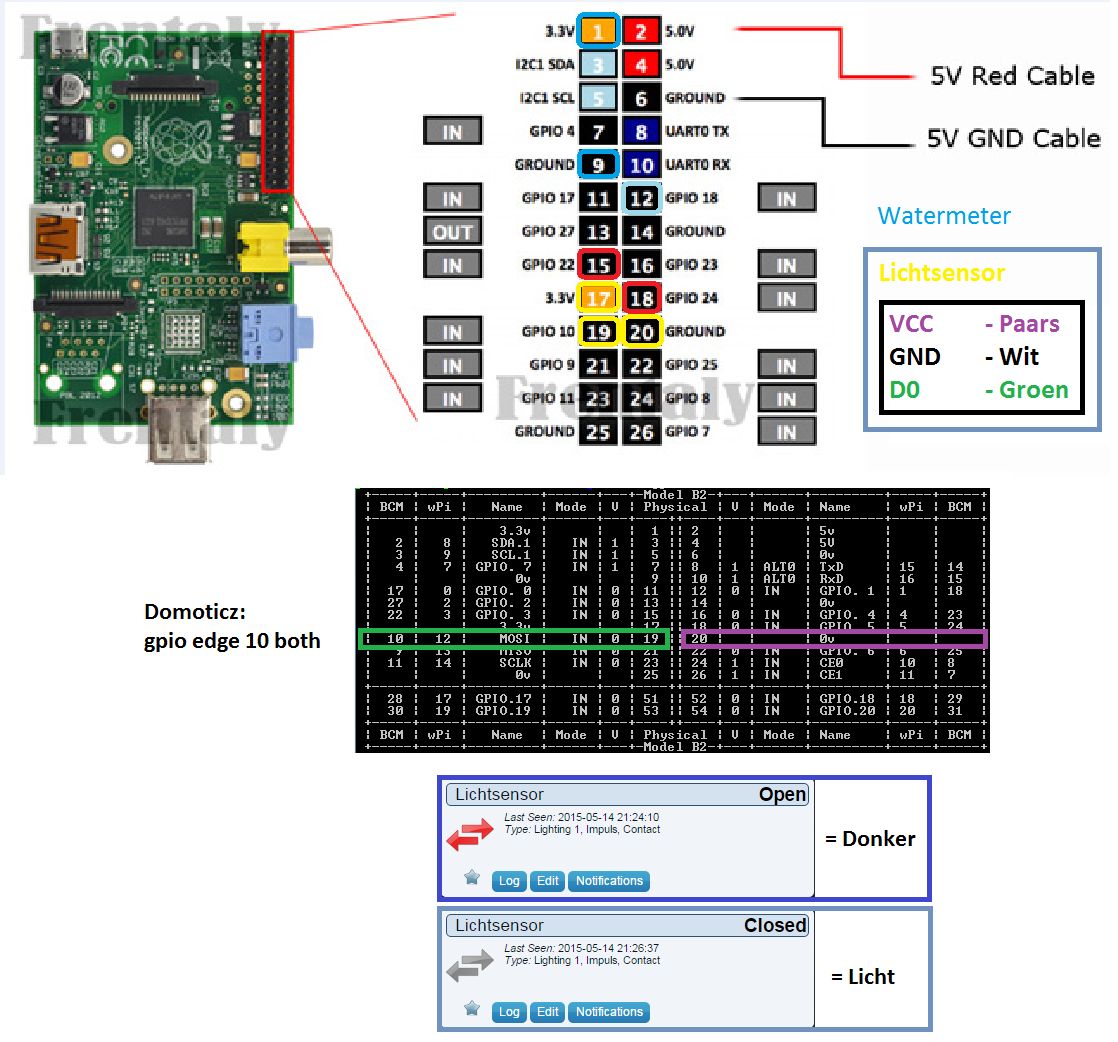

Yesterday my neighbor and I installed a water meter with a TCRT5000 board. I have connected the sensor on pin 12 GPIO 18.
If i start manually /usr/local/bin/gpio export 18 in and then /home/pi/domoticz/domoticz my water counter works.
But when we place /usr/local/bin/gpio export 18 in in the domoticz.sh script we get an error.

Ok Running v2.2563 on Raspberry Pi 2.
I did the following:
1. DOWNLOAD & INSTALL WIRING PI http://wiringpi.com/download-and-install/
2. Create the exports my Watermeter is connected to
2. Check the export:
3. To have the GPIO available in Domoticz I added the following lines to the /etc/init.d/domoticz.sh script as described here: https://www.domoticz.com/wiki/GPIO
At the end of the file after the ":"
#Run export GPIO Raspberry
/usr/local/bin/gpio edge 18 both
4. Reboot the system
This is working okay, no error messages.

Just added 4,7k resistor between 3,3v and GND pin.
Modified the LUA script from:
to:

Have a look here for my mounting bracket.joostnl wrote:The idx value of '117' is my GPIO Switch so I used this in the script
I added a flowmeter called: 'Water' with a dummy hardware, then add virtual sensor is this correct?
Another question: How did you mount the sensor and why you used a resistor inbetween?
Thanks for your responds, im pretty new to scripting![]()
------------------------------------------------------------------------------ -- Script parameters ------------------------------------------------------------------------------ debug = true -- Turn debugging on ("true") or off ("false") ------------------------------------------------------------------------------ commandArray = {} metername="Watermeter" meteridx=117 if (debug) then print('> Monitoring water consumption') end -- Water usage -- Retrieve value from water meter device: sWaterUsage = otherdevices_svalues[metername] -- To have a better readable format, divide number by 1000: sWaterUsagePrint = tonumber(sWaterUsage / 1000); -- calculation is done with the unmodified water value sWaterUsage = tonumber(sWaterUsage); if (debug) then print(">> Utilities: Water usage until now is " .. sWaterUsagePrint .. " "); end if (devicechanged['Water'] == 'Closed') then sWaterUsageTot = (sWaterUsage + 0.5) print(">> Utilities: Water usage is now " .. sWaterUsageTot .. " "); commandArray['UpdateDevice']=meteridx .. "|0|" .. sWaterUsageTot end return commandArray
viewtopic.php?t=2157&start=20
viewtopic.php?t=5021#p64026
The resistor was used as a pull down to avoid false positives.
In the end I removed it and solved the whole watermeter in a different way.
as described here: viewtopic.php?t=5021#p41946. It has been working for over 2 years now flawless with isrcounter.

Thanks for your photo's I made a simular bracket from DIN RAIL.
I tuned the sensor that the green light go's on when the reflective part of the water meter passes by. I found it to hard to point it at the end of the red arrow.
Must i change my sensor now to NO or NC?
Without your script i get some times an error.
"2017-02-18 17:19:30.120 Error: Watermeter hardware (13) thread seems to have ended unexpectedly"
This is not normal right?
I got the script working, i was confused with were 'water' and 'watermeter' had to be haha
Why are you counting with 0.5? I thougth 1 revolution was 1 L not 0.5
