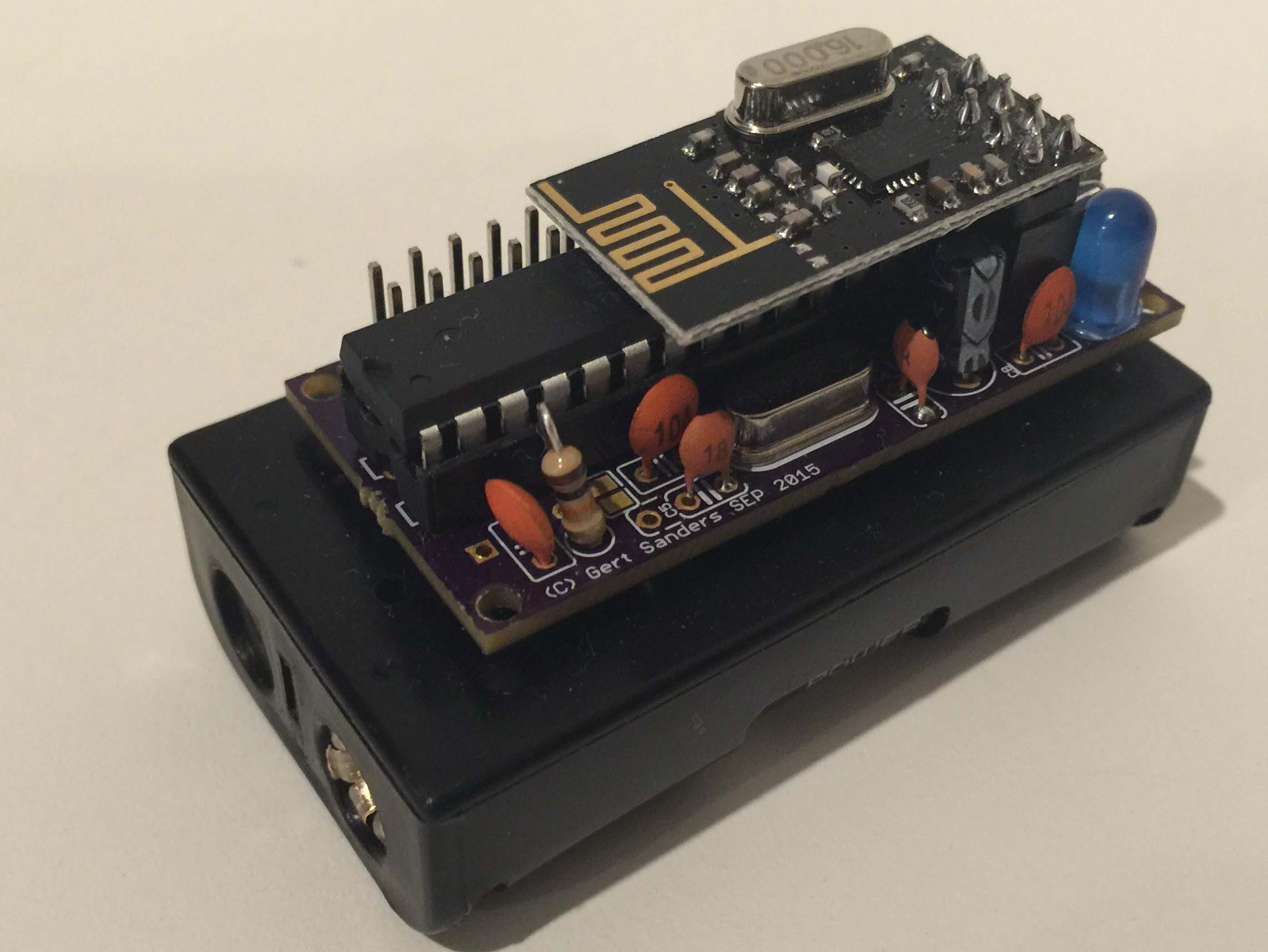

This is pretty much what I have done with my BMP180 and Mysensors
I have fabricated a node (in the photo) running on two AA batteries and connected BMP180 via I2C. With a credit to some Mysensors guys the sketch below works just fine, which was adopted for my custom built, but with a very minor alternations, the sketch should work on any atmega328 (Arduino Pro Mini)
Have a look at the forecasting algorithm.
You can adopt it for Raspberry Pi.

2015-12-11 09.29.09-1.jpg (191.26 KiB) Viewed 6210 times

Post by alexsh1 »
stlaha2007 wrote:
Can you enlighten me a little bit more, like does it so to say sleep, seen something that looked like a while, so does it need to be backgrounded?
Grtz,
Stephan
I do not know where to start :D :D
Basically, you have to look into the loop, again averages may come in later.
void loop()
  measureCount ++;
  sendBattery ++;
  bool forceTransmit = false;
  if ((measureCount == 5) && highfreq)
    clock_prescale_set(clock_div_8); // Switch to 1Mhz for the reminder of the sketch, save power.
    highfreq = false;
  if (measureCount > FORCE_TRANSMIT_INTERVAL) { // force a transmission
    forceTransmit = true;
    measureCount = 0;
  float pressure = bmp.readSealevelPressure(ALTITUDE) / 100.0;
  float temperature = bmp.readTemperature();
  if (!metric)
    // Convert to fahrenheit
    temperature = temperature * 9.0 / 5.0 + 32.0;
  int forecast = sample(pressure);
  Serial.print("Temperature = ");
  Serial.print(temperature);
  Serial.println(metric ? " *C" : " *F");
  Serial.print("Pressure = ");
  Serial.print(pressure);
  Serial.println(" hPa");
  Serial.print("Forecast = ");
  Serial.println(weather[forecast]);
  if (temperature != lastTemp)
    gw.send(tempMsg.set(temperature, 1));
    lastTemp = temperature;
  if (pressure != lastPressure)
    gw.send(pressureMsg.set(pressure, 0));
    lastPressure = pressure;
  if (forecast != lastForecast)
    gw.send(forecastMsg.set(weather[forecast]));
    lastForecast = forecast;
  digitalWrite(LED_PIN, HIGH);
  delay(50);
  digitalWrite(LED_PIN, LOW);
  if (sendBattery > 60)
     sendBattLevel(forceTransmit); // Not needed to send battery info that often
     sendBattery = 0;
  gw.sleep(SLEEP_TIME);
1) After a certain value, it forces to transmit pressure/temp
2)There is a forecast algorithm; there is a link and I suggest you follow the link to understand how it works.
3) The LED is flashed as soon as gw.send is gone for temp/pressure/forecast
4) battery voltage is sent once in the while, there is no need to send it every time.
5) it goes to sleep for SLEEP_TIME
This is it, the rest is just details. :D
