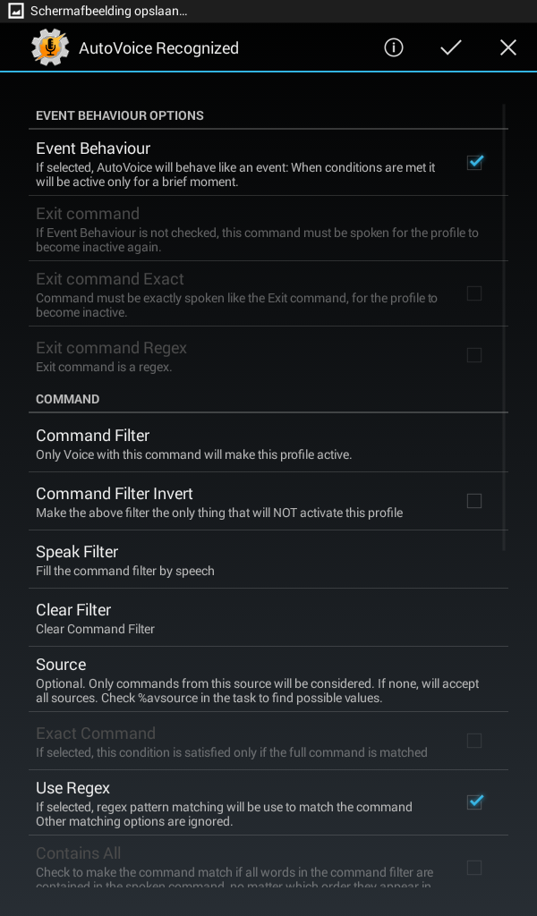

In Autotask go to Profiles and press the plus. Choose State -> Plugin -> Autovoice -> Recognized
In the new screen choose the edit button and tick Event behaviour and Use Regex like this:

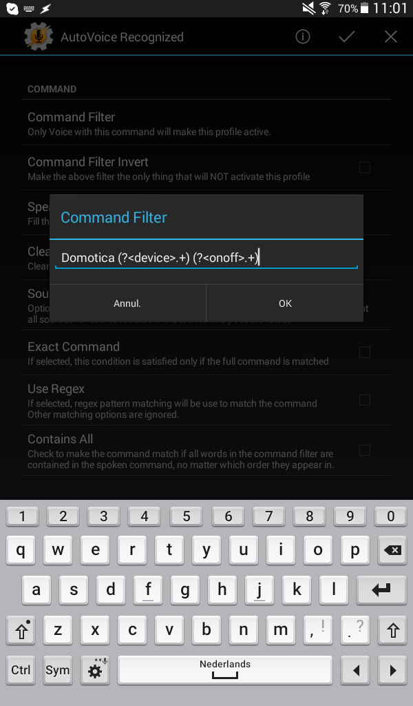

In command filter type:
This is the pattern Autovoice is gonna recognize:
Domotica is the trigger for the Domotica command
(?<device>.+) is the device we want to operate
(?<onoff>.+) is the command we want to execute (On or Off)
Click OK and on the next screen the V.

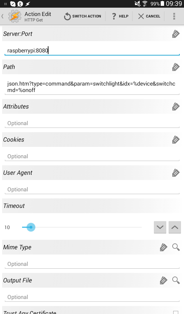

Click the Plus to add the task. Use Net ->HTTP get to create the http task to do stuff on Domoticz
Type the servername and port of the Domoticz server (I my case raspberrypi:8080) on server:port
In the path type:
json.htm?type=command&param=switchlight&idx=%device&switchcmd=%onoff
Like this:
