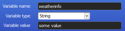

1. Create a user variable in Domoticz
(this variable shall retain ALL the weather info, semi-colon (;) separated. I prefer this method because it will not 'pollute' the Domoticz GUI)
in Domoticz, go to the menu Setup > More Options > User variables
create a new variable, eg. 'weatherinfo', type String, and give it some value, then Add it
write down the name of the User Variable, and the corresponding Idx (in this example 18)
