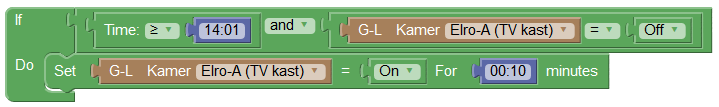

I created an first event, but have no idea why it is not working. Does anyone have a suggestion?
Elro-A (Tv kast) is a switch
Thanks for the support

On for 10 minutes (not 00:10)

Thanks Westcott,
It works, super this support
