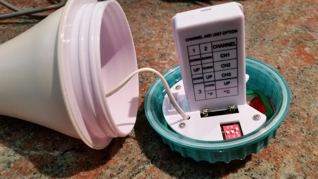

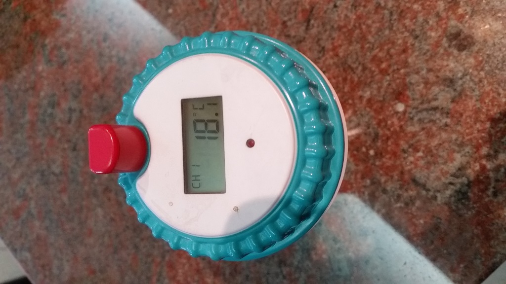

My pool thermometer appears that is not recognized by RFLink/Domoticz.
Buy from
http://www.dx.com/it/p/wireless-indoor- ... ryK1_nhDcs
Domoticz Log
2016-02-11 13:57:12.636 RFLink: 20;00;Nodo RadioFrequencyLink - RFLink Gateway V1.1 - R37;
2016-02-11 13:57:12.636 RFLink: Controller Initialized!...
RfLink log
20;08;DEBUG;Pulses=32;Pulses(uSec)=4440,2340,2250,2340,4650,4710,4650,4710,2250,2340,2250,2340,4650,4710,4620,2340,2250,2340,2250,4710,4650,2340,2250,4740,4650,2340,2250,4740,2250,2340,2250,6990;
20;09;DEBUG;Pulses=32;Pulses(uSec)=4410,2340,2250,2340,4650,4740,4650,4710,2250,2340,2250,2340,4650,4710,4650,2340,2250,2340,2250,4710,4650,2340,2250,4710,4650,2310,2250,4710,2250,2340,2250,6990;
20;0A;DEBUG;Pulses=32;Pulses(uSec)=3870,2340,2250,2340,4650,4710,4650,4710,2250,2310,2250,2340,4650,4710,4650,2310,2250,2340,2250,4710,4650,2340,2250,4710,4650,2340,2250,4710,2250,2310,2280,6990;
20;0B;DEBUG;Pulses=32;Pulses(uSec)=3720,2340,2250,2340,4650,4710,4650,4710,2250,2340,2250,2310,4650,4710,4650,2340,2250,2310,2250,4710,4650,2310,2250,4710,4650,2310,2250,4710,2250,2310,2250,6990;
20;0C;DEBUG;Pulses=32;Pulses(uSec)=4440,2340,2250,2310,4650,4710,4650,4710,2250,2340,2250,2310,4650,4710,4650,2340,2250,2310,2250,4710,4650,2310,2250,4710,4650,2310,2250,4710,2250,2340,2250,6990;
20;0D;DEBUG;Pulses=32;Pulses(uSec)=4440,2340,2250,2340,4650,4710,4650,4710,2250,2340,2250,2310,4650,4710,4650,2340,2250,2340,2250,4710,4650,2310,2250,4740,4650,2310,2250,4710,2250,2340,2250,6990;
20;0E;DEBUG;Pulses=32;Pulses(uSec)=3870,2340,2250,2310,4650,4710,4650,4710,2250,2340,2250,2310,4650,4710,4650,2340,2250,2310,2250,4710,4650,2310,2250,4710,4650,2310,2250,4710,2250,2340,2250,6990;
20;0F;DEBUG;Pulses=32;Pulses(uSec)=3870,2340,2250,2340,4650,4710,4650,4740,2250,2340,2250,2310,4650,4710,4650,2340,2250,2340,2250,4710,4650,2340,2250,4710,4650,2340,2250,4710,2250,2340,2250,6990;
20;10;DEBUG;Pulses=32;Pulses(uSec)=3840,2340,2250,2340,4650,4740,4650,4710,2250,2340,2250,2340,4650,4710,4650,2340,2250,2340,2250,4710,4650,2340,2250,4710,4650,2310,2250,4710,2250,2340,2250,6990;
20;11;DEBUG;Pulses=32;Pulses(uSec)=4440,2340,2250,2340,4650,4710,4650,4710,2250,2340,2250,2340,4650,4710,4650,2340,2250,2340,2250,4740,4650,2340,2250,4710,4650,2340,2250,4710,2250,2340,2250,6990;
20;12;DEBUG;Pulses=32;Pulses(uSec)=3870,2340,2250,2340,4650,4710,4650,4710,2250,2340,2250,2340,4650,4710,4650,2310,2250,2340,2250,4710,4650,2340,2250,4740,4650,2340,2250,4710,2250,2340,2250,6990;
20;13;DEBUG;Pulses=32;Pulses(uSec)=4410,2340,2250,2340,4650,4710,4650,4710,2250,2340,2250,2340,4650,4710,4650,2340,2250,2340,2250,4740,4650,2340,2250,4740,4650,2340,2250,4710,2250,2310,2250,6990;
20;14;DEBUG;Pulses=32;Pulses(uSec)=3870,2340,2250,2310,4650,4710,4650,4710,2250,2340,2250,2340,4650,4710,4650,2340,2250,2340,2250,4710,4650,2340,2250,4710,4650,2310,2250,4710,2250,2340,2250,6990;
20;15;DEBUG;Pulses=32;Pulses(uSec)=4560,2340,2250,2340,4650,4710,4650,4740,2250,2340,2250,2340,4650,4710,4650,2340,2250,2340,2250,4710,4650,2340,2250,4710,4650,2310,2250,4710,2250,2340,2250,6990;
20;16;DEBUG;Pulses=32;Pulses(uSec)=3870,2340,2250,2340,4650,4710,4650,4710,2250,2310,2250,2340,4650,4710,4650,2340,2250,2340,2250,4740,4650,2340,2250,4710,4650,2340,2250,4740,2250,2340,2250,6990;
20;17;DEBUG;Pulses=32;Pulses(uSec)=4560,2340,2250,2340,4650,4710,4650,4710,2250,2340,2250,2340,4650,4710,4650,2340,2250,2340,2250,4710,4650,2310,2250,4710,4650,2340,2250,4710,2250,2340,2250,6990;
20;18;DEBUG;Pulses=32;Pulses(uSec)=3870,2340,2250,2340,4650,4740,4650,4710,2250,2340,2250,2340,4650,4740,4650,2340,2250,2310,2250,4710,4650,2340,2250,4710,4650,2340,2250,4710,2250,2340,2250,6990;
Thanks for help
Pool thermometer not recognized

Unfortunately still does not work because:
the swimming pool thermometer WT1022, recognized by RFLink, as explained to me by the developer sends this message:
20; 66; DEBUG; Pulses = 96; Pulses (uSec) = 450,930,390,930,390,930,39 ......
Packets with a length of at least 96 pulses and pulse times of ~ 450 and 900.
the thermometer sold by Dx.com (Model WT0122) looks the same but it sends different packets.
Like this:
20; 41; DEBUG; Pulses = 32; Pulses (uSec) = 3450,2340,2250,2340,4650,4710, ....
Like this:
