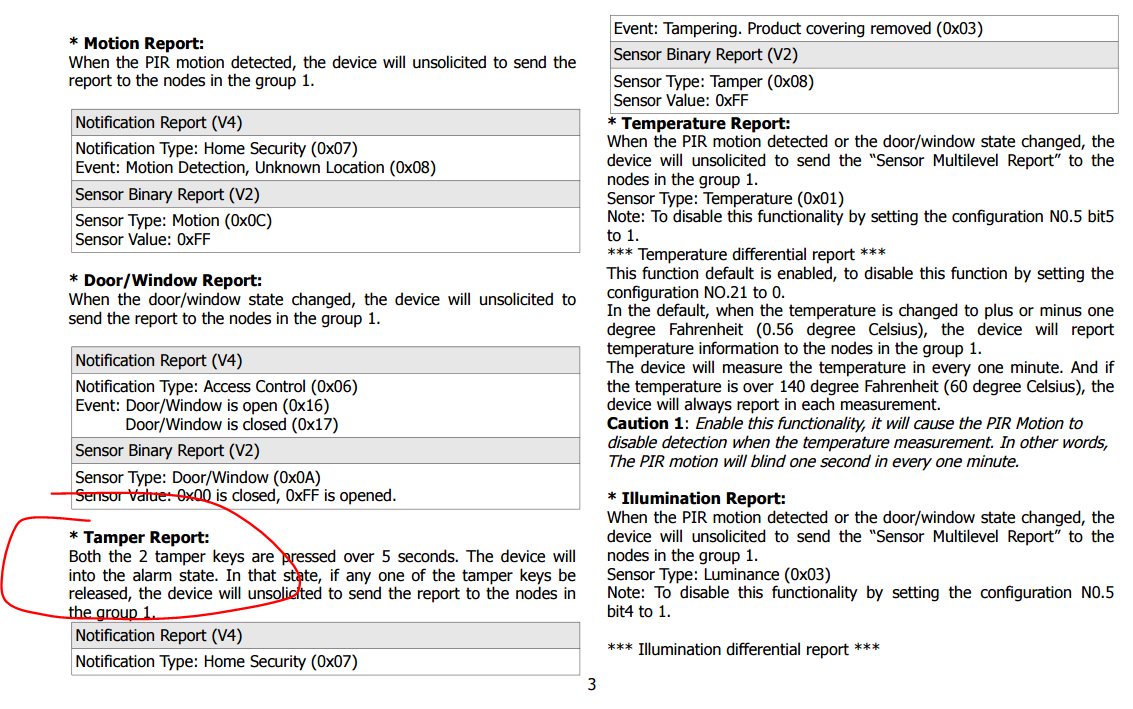

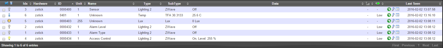

I just got 6 DCH-Z110 door/window sensors and Aeon Z-Stick Gen 5 and decided to go with Domoticz after testing other controllers. I can add all nodes just fine and the door/window sensor reports correctly open/close state. Luminance, temperature and battery work great too. But I'm stuck on the tamper sensor, I can't get it to work but this is pretty essential function so I don't want to give up.
Whenever I release the tamper button, I see that Alarm Type and Alarm Level values log "Off" value. So something happens, but something else than I would expect. The problem is that this Off comes also automatically after some time (like 8 hours) despite no tampering happening and the Off is also logged whenever the window closes or opens. So this is not the right tamper detection.
Could someone please suggest what am I doing wrong? Attaching 2 images if that might help. The log shows "OpenZWave: Alarm Level: Secure" when I release the tamper button but also whenever window opens/closes.
