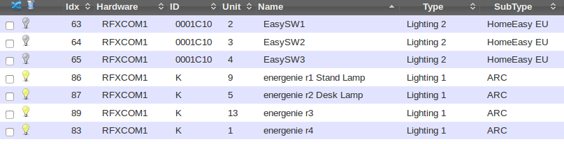

Just came across this, was trying to add some energenie ener002-c sockets.
It just clicked when you have a Homeeasy remote. (No pun intended)
0. Set mode on the RFXCOM hardware device in Domoticz to ARC only
1. Put the energenie socket in Learning mode.
2. Press On/off on 1. on the homeeasy remote.
3. The Energenie remote will trigger on/off (and place an entry in the devices list on Domoticz)
4. Rename that device (not essential but easier to know which you have done.)
It should have an entry for example of RFXCOM1--------K----5--------ARC etc
5. It should now trigger as on/off in Domoticz. (Obviously If you have homeeasy devices and are using the remote, it means the remote is now relatively useless (as it will trigger two devices) but I'm not so now I have a Homeeasy Socket and a Energenie socket working independently of each other with a common "Learn" but if you stick to domoticz and rfxcom it doesn't trigger both.
6 Repeat for the other sockets.
Re: Smarter way of using multiple remotes?!

haven't got a clue....I assume that's the protocol the Energenie uses. It just works :)......I thought I had bought a "Lemon" but, the mentioning of the Homeeasy remote, Must be similar to AC the one Homeeasy uses but ARC appears in Domoticz when you press the buttons on the homeasy remote when put the Energenie in learn.
As I said yep if you press the homeasy button you will get two sockets on, but in domoticz and I assume rfxcom, they are seperate and can be triggered seperately.

Just to add I did all this without rfxmgr, only using Domoticz's Hardware Screen - Rfxcom (Set Mode) and Devices screen from the Domoticz webgui on the RPI.
