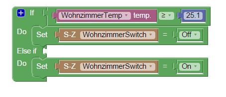

i tried to create a blocky event to set off my switch when my fibaro motion sensor reaches 25 degrees... but the event doesent firing... :(
It only fires when i combine it with a switch and toggle the switch manuelly.
Heeellllpppp :( :)

try this: if wohnzimmerswitch=off and wohnzimmertemp>25.1 , set wohnzimmerswitch=on
elseif wohnzimmerswitch=on and wohnzimmertemp<25 , set wohnzimmerswitch=off
