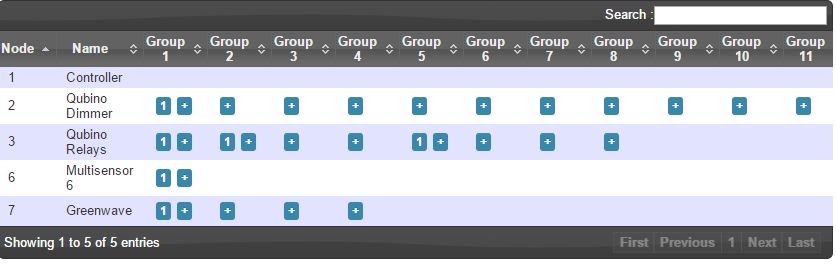

Thanks for the answer! I messed up things by adding groups.
But removing all the additional groups makes it work fine!
(I don't really know what I am doing, but very happy it is finaly working!)
But when I reboot the raspberry it adds 1+ to group 1 and I have to remove it again.
Any suggestion to solve it permanently?

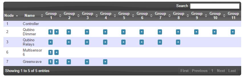

But the wall switches are not working then, they dont report....'
If i change it, its not working well again. see image --> But now it always reports that I1 is on when i use the wall switches. (for both)
So if I turn on I2 on de wall switch, it reports I1 is on. And i2 is off...
ideas?
ideas?

remove this line from /home/pi/domoticz/Config/qubino/ZMNHBD2.xml (I suppose you mean 2 at the end)
Also read this post for some more information and a workaround for the status update: http://www.domoticz.com/forum/viewtopic.php?f=17&t=7043
<CommandClass id="96" mapping="endpoints" />

Re: Qubine ZMNHBD1 not working well
Now I do have 3 switches but the device gets marked as dead by OZW when the initial check ends so nothing works
