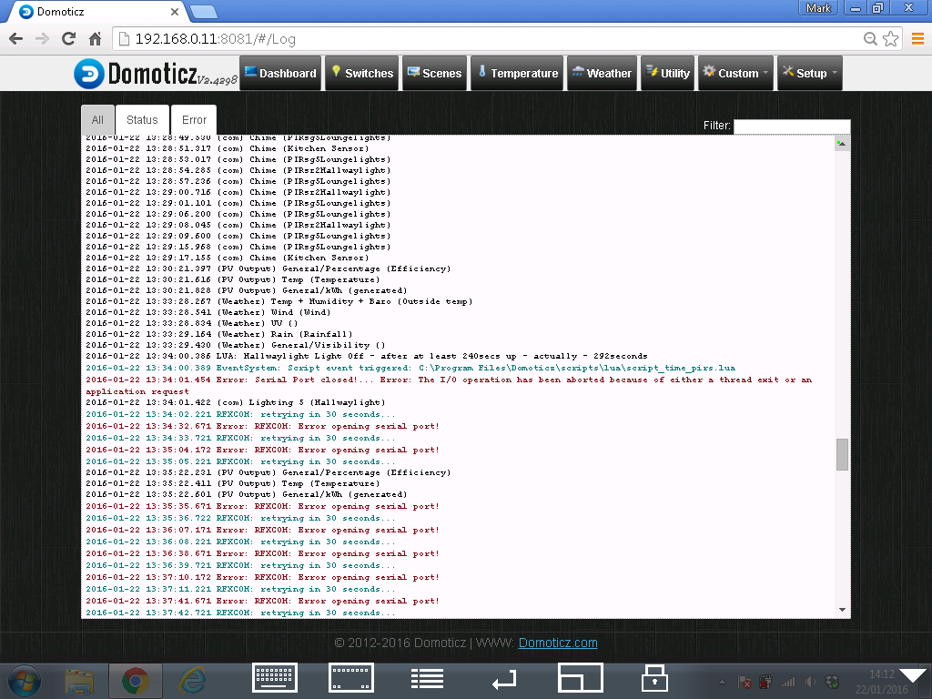

I recently changed my hardware from a RFXtrx433 to a RFXtrx433e which seemed to be working ok but it now keeps crashing. I attach the log for more details. I was running on windows V.2.4078 but upgraded to V 2.4298 today although the problem still keeps happening. I'd be grateful if anyone could suggest something to try to fix this. Thanks.
EDIT: just to add, restarting Domoticz boots it up again but it fails again soon afterwards.
Error log.PNG (129.18 KiB) Viewed 797 times

I think you need to search for thr persistent usb settings

I removed the RFXcom from the USB hub it was connected to and plugged it straight into the PC to test and it's been running ok for the past 24 hours. Fingers crossed.
