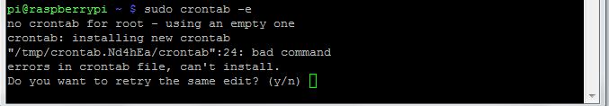

First I write "sudo crontab -e"
pi@raspberrypi ~ $ sudo crontab -e
After I have written in the crontab file and save it, the below text comes up in Putty.
no crontab for root - using an empty one
crontab: installing new crontab
"/tmp/crontab.IrAEuT/crontab":24: bad command
errors in crontab file, can't install.
Do you want to retry the same edit? (y/n)
What´s the problem?
stlaha2007
- Posts: 370
- Joined: Monday 05 October 2015 10:16
- Target OS: -
Re: Help with LUA - updating status?
two questions...
What have you tried to put into your crontab (perhaps make a screendump[just select the text when you have a putty-session open and paste it here])
Why sudo crontab -e? cron will run under user pi also. There is no need to run it as root.
Grtz,
Stephan
Grtz,
Stephan

Rena
- Posts: 19
- Joined: Monday 21 September 2015 20:17
- Domoticz version: V 3.8153
- Location: Sweden
Screenshot from putty, same problem even if I´m running as "pi"
Suggestions?
Suggestions?

Rena
- Posts: 19
- Location: Sweden
I tried PM2 as Fergalom suggested, works great and was easy to use.
Case closed!
