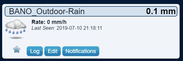

by Trigun
[/quote]
Jep I got one. I have a Netatmo weather station which gives me the following.
how does that work? can I use it with pass2php?
ideally I would like to stick with the 5am as this is the most ideal time to water the lawn (just before sunrise) :)
the 12 hours might change.
is this possible?
Re: Pass2PHP
Posted: Thursday 11 July 2019 6:58
by Egregius
something like this in a one of the cron files:
<?php
if (TIME>=strtotime('5:00')&&TIME<strtotime('6:00')&&past('BANO_Outdoor-Rain')>43200&&$d['Rain expected']['s']=='Off'&&past('Water')>43200&&$d['Water']['s']=='Off') {
	sw('Water', 'On');
if ($d['Water']['s']=='On'&&past('Water')>900) {
	sw('Water', 'Off');

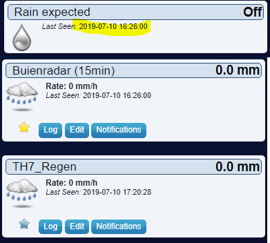

But I have a few questions to understand.
TIME>=strtotime('5:00')&&TIME<strtotime('6:00') --> does this mean: when time is between 5am and 6am? (this is a new function for me, sorry :) )
('BANO_Outdoor-Rain')>43200&&$d['Rain expected']['s']=='Off'&&past('Water')>43200&&$d --> I don't have A "rain expected" sensor but I guess if Bano Rain is >43200 it will work right?
if ($d['Water']['s']=='On'&&past('Water')>900) { --> this means the sprinklers will be on for 15 minutes?
sw('Water', 'Off');

I'll split the code in severall lines for you ;)
<?php
if (TIME>=strtotime('5:00') // If time of day is later than 5am
	&&TIME<strtotime('6:00')// And if time of day is before 6am
	&&past('BANO_Outdoor-Rain')>43200 // And if BANO_Outdoor-Rain hasn't been updated in the last 43200 seconds (12 hours)
	&&$d['Rain expected']['s']=='Off' // And if there's no rain expected
	&&past('Water')>43200 // And the water hasn't been turned on in the last 12 hours
	&&$d['Water']['s']=='Off' // And the water is off
	sw('Water', 'On'); // Switch on the water
if ($d['Water']['s']=='On' // If the water is on
	&&past('Water')>900 // And it's on for more than 900 seconds (15 minutes)
	sw('Water', 'Off'); // Turn off the water
