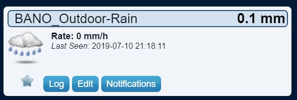

Trigun
Posts: 390
Domoticz version: 4.10717
Re: Pass2PHP
Post by Trigun »
[/quote]
Jep I got one. I have a Netatmo weather station which gives me the following.
how does that work? can I use it with pass2php?
ideally I would like to stick with the 5am as this is the most ideal time to water the lawn (just before sunrise) :)
the 12 hours might change.
is this possible?
Egregius
Posts: 2592
Domoticz version: v2024.7
Location: Beitem, BE
Re: Pass2PHP
Post by Egregius »
something like this in a one of the cron files:
<?php
if (TIME>=strtotime('5:00')&&TIME<strtotime('6:00')&&past('BANO_Outdoor-Rain')>43200&&$d['Rain expected']['s']=='Off'&&past('Water')>43200&&$d['Water']['s']=='Off') {
	sw('Water', 'On');
if ($d['Water']['s']=='On'&&past('Water')>900) {
	sw('Water', 'Off');
Trigun
Posts: 390
Re: Pass2PHP
Post by Trigun »
Egregius wrote: Thursday 11 July 2019 6:58 something like this in a one of the cron files:
<?php
	sw('Water', 'On');
	sw('Water', 'Off');
I think that's it, Thank you Egregius!
But I have a few questions to understand.
TIME>=strtotime('5:00')&&TIME<strtotime('6:00') --> does this mean: when time is between 5am and 6am? (this is a new function for me, sorry :) )
('BANO_Outdoor-Rain')>43200&&$d['Rain expected']['s']=='Off'&&past('Water')>43200&&$d --> I don't have A "rain expected" sensor but I guess if Bano Rain is >43200 it will work right?
if ($d['Water']['s']=='On'&&past('Water')>900) { --> this means the sprinklers will be on for 15 minutes?
sw('Water', 'Off');
