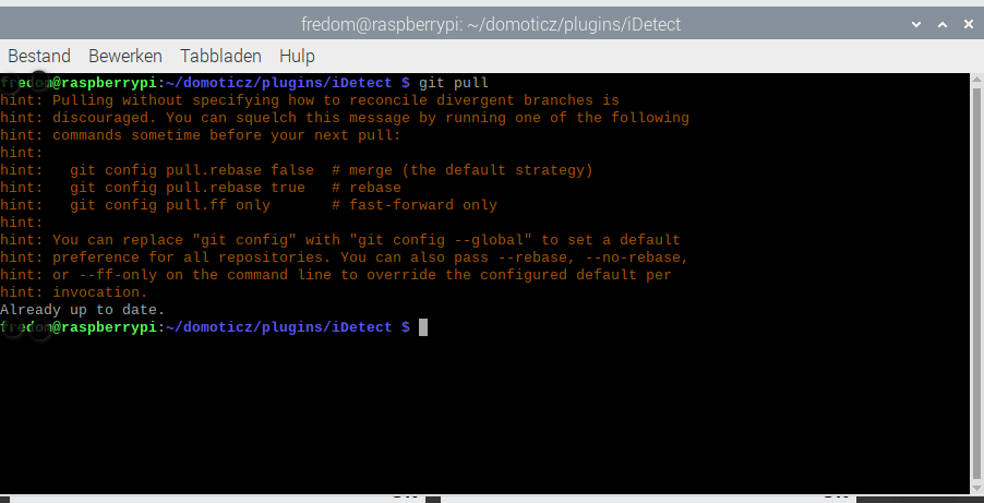

Hi EscApe,EscApe wrote: Friday 13 October 2023 17:02 Hi Fred,
The most likely reason is a required module that is not installed on the 2nd rpi. I cant't tell much from the limited log. If you need more help then please enable debugging and share a log from the moment the plugin is started for the first time.
Thanks for the quick reply.
I enabled the debug and restarted the system.
After 15 minutes I restarted Domoticz again. In both cases there is nothing in the Domoticz log. I hope that the information from 'All' and 'Status' is sufficient for the diagnosis

Fredom
- Posts: 160
- Joined: Saturday 19 September 2020 21:02
- Domoticz version: 2025.1
- Location: Krimpen aan den IJssel
Re: Python plugin: Presence detection from wireless router
Hi EscApe,EscApe wrote: Tuesday 24 October 2023 12:21 Looks like it is not using the new (beta) plugin, since the new plugin would not try to import Paramiko. Ik will import pssh instead.
What do you mean by 'installed over it'? Is it in the same folder or next to the existing folder?
You need to remove the old plugin folder. Otherwise Domoticz will have two folders containing a plugin with the same name and key.
Are you sure you installed the correct branch?
I deleted all idetect folders and the hardware plugin.
Restarted and then entered your code in the domoticz plugin folder via the terminal.
Then I restarted again, now no errors, but it didn't work either. Then installed the hardware plugin and restarted.
It doesn't work yet, but there is another error.
2023-10-24 13:21:17.622 Error: iDetect: Call to function 'onStart' failed, exception details:
2023-10-24 13:21:17.680 Error: iDetect: Traceback (most recent call last):
2023-10-24 13:21:17.680 Error: iDetect: File "/home/fredom/domoticz/plugins/iDetect/plugin.py", line 442, in onStart
2023-10-24 13:21:17.680 Error: iDetect: _plugin.onStart()
2023-10-24 13:21:17.680 Error: iDetect: File "/home/fredom/domoticz/plugins/iDetect/plugin.py", line 315, in onStart
2023-10-24 13:21:17.680 Error: iDetect: handle_unused_unit(d)
2023-10-24 13:21:17.680 Error: iDetect: File "/home/fredom/domoticz/plugins/iDetect/plugin.py", line 177, in handle_unused_unit
2023-10-24 13:21:17.680 Error: iDetect: Devices[device].Units[unit].TimedOut=1
2023-10-24 13:21:17.680 Error: iDetect: AttributeError: 'DomoticzEx.Unit' object has no attribute 'TimedOut'Yours sincerely,
Fred

Hi,EscApe wrote: Tuesday 24 October 2023 18:31 The log still mentions the bug a have already fixed. Looks like the plug-in was not updated to my latest changes (git pull)
Okay, I have now done a gitt pull and now only 1 error
2023-10-24 21:44:19.040 Error: iDetect: Required modules for default tracker are not installed:No module named 'pssh'
