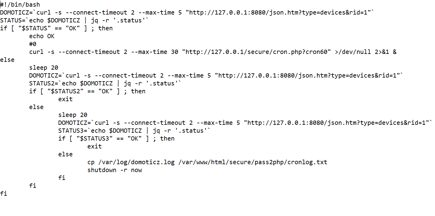

I did change the cron.sh file as I didn't need most of the lines(so I thought), see attached. so basically when I keep the
&&$d['PIR-Bijkeuken']['s']=='Off' this is a mystery to me.
