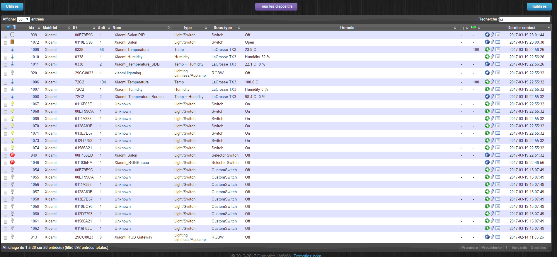

This is now what I have in the device list.Mat2Vence wrote:corbin wrote: So you have removed ALL the duplicates, and still have problems with device updates?
- xiaomi.PNG (234.74 KiB) Viewed 3221 times
- corbin
- Posts: 463
- Joined: Saturday 20 August 2016 22:57
- Target OS: Windows
- Location: Brisbane, Australia
you have a heap of duplicates there, eg ID 0110BC90. All the devices listed as Unknown and CustomSwitch, delete them.
make sure each 'ID' is unique.

How can I remove them? There a re just in the device list, but not part of the use ones... How should I proceed? Thnaks for your helpcorbin wrote:you have a heap of duplicates there, eg ID 0110BC90. All the devices listed as Unknown and CustomSwitch, delete them.

Tick the check boxes at the very left of each row, then click the trash/delete icon near the top. It is small the small blue icon - not very obvious.Mat2Vence wrote: How can I remove them? There a re just in the device list, but not part of the use ones... How should I proceed? Thnaks for your help
