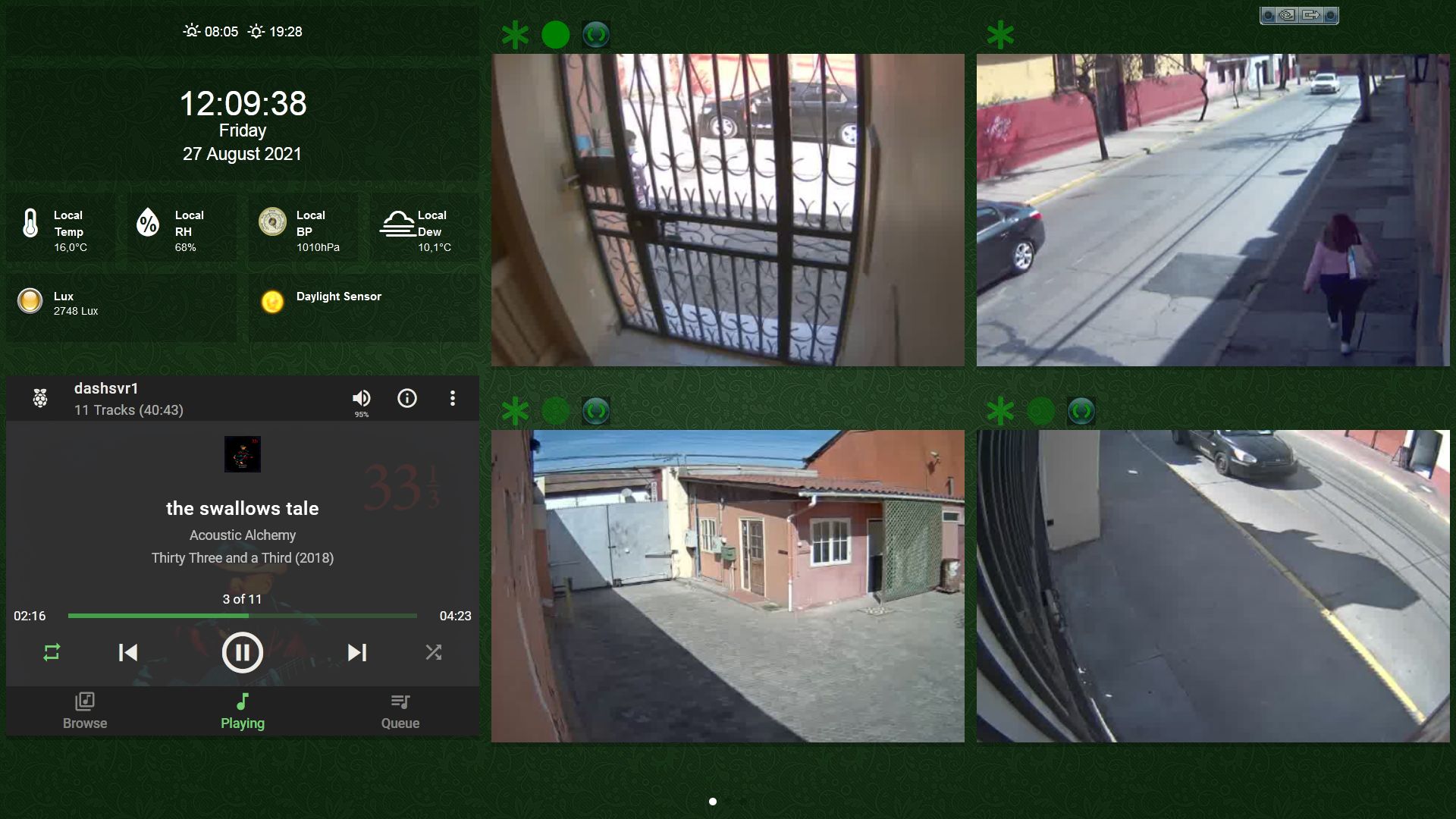

Sorry for the latency... I'd suggest you try the material skin (a plug-in in Squeezeserver). Then create an iFrame for it. It is so much prettier than the standard squeezebox players.

stephanvdplas wrote: Tuesday 10 August 2021 15:18 Sorry for the latency... I'd suggest you try the material skin (a plug-in in Squeezeserver). Then create an iFrame for it. It is so much prettier than the standard squeezebox players.
This is a great suggestion, thanks! I had been under the mistaken impression that the Logitech Media Server only worked with proprietary gadgets, so hadn't checked it out. I installed it standalone on a Raspberry Pi3 together with Dashticz, and it runs very well. On the Pi, the hardest part was getting the external USB sound card to be recognized, but that's not unusual.
