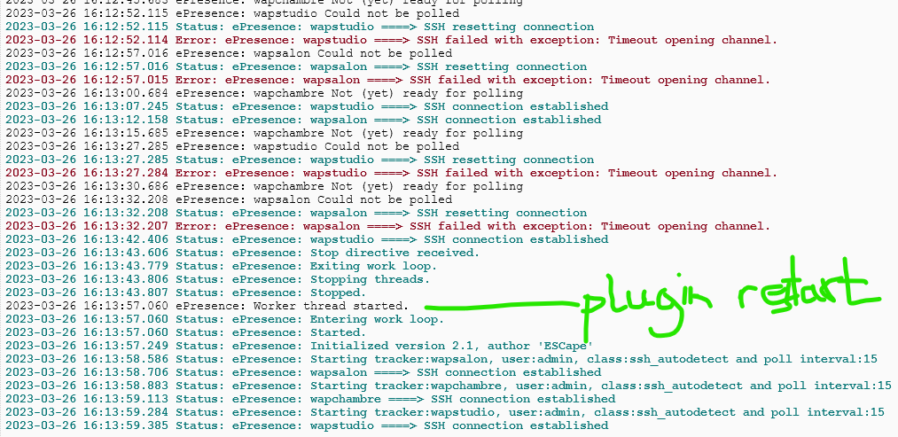

Re: Python plugin: Presence detection from wireless router
3 ASUS RT-AC68U configured as WAP only (AP Mode)make and model is your router?
less than 20 clients, 5 connected usually
when I do the top command on one of them I've got
Mem: 61616K used, 194084K free, 860K shrd, 1072K buff, 8028K cached
CPU: 1.2% usr 3.5% sys 0.0% nic 94.5% idle 0.0% io 0.0% irq 0.5% sirq
Domoticz in on a 1Gb Ethernet
Yes, I've just restart domoticz on the other server, and it's running fine.the plug-in is running fine on another domoticz setup?
And for the bottlenecks, while there are issues on one dz instance, the other one is running well, and when I restart the plugin, both are running well. So no specific issue with bottlenecks.

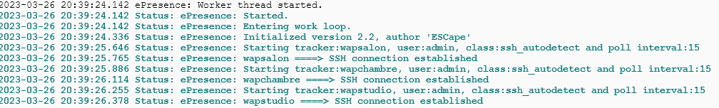

new install on the same RPI in another folder with an empty database
=> only 2 plugins
- iDetect version 2.2
- zigbeeForDomoticz
same issue
=> only 2 plugins
- zigbeeForDomoticz
same issue

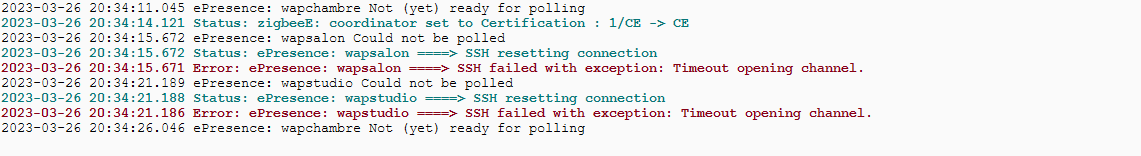

There are some hardcoded timeouts in ssh_tracker.py. Can you try ans Increase them? Especially line 91:
These times are very short (on purpose), but maybe it is just too close for your environment.
def getfromssh(self, tracker_cli, alltimeout=5, sshtimeout=3):
- Posts: 361
- Joined: Monday 25 December 2017 23:06
- Domoticz version: 2022.1
- Location: Paris
done,
no change
I think there is no specific limit on my env, as it works after disable/enable the plugin
- Posts: 536
- Joined: Thursday 02 April 2015 8:46
- Domoticz version: 2020+
Okay… something else to try:
You are polling three routers and all of them every 15 seconds. Can you change the poll-interval to 30 seconds. If that doesn’t help change it to 1 minute. Just to diagnose this issue.
- Posts: 361
- Location: Paris
directly with 1 router and 60 secondes
same error, but 1 min after!

Hi @hestia,
From the different logs you have shared I can't really see a pattern. Do I summarize correctly that:
- sometimes it works for two out of three routers but fails later on?
- it is not always the same routers that do work and that fail?
- after a restart of the plugin It works again?
- in you last log it doesn't work at all?
- on a different domoticz installation it works without any problems?
To make future diagnostics a bit easier please share complete debug logs from the moment the plugin starts until after the first poll (attempt) and alle messages around the failure. I don't think I need other logs right now (if the above is correct), but when testing in the future. Otherwise it is a bit of a puzzle ... and the issue is puzzling enough as it is
The problem still might be some weird congestion or connecting failure caused by a network driver, different python version or modules (like ssh and paramiko), other tasks that block the router from responding in time etc etc etc....
I no longer use a Asus (or other ssh based) tracker myself, so it will take me some time to build a test setup using one of my old Asus routers. In the meantime you could try a fresh install using the same python version and modules (version).
A ran the ssh tracker with two Asus routers without any problems until little over a year ago. You could also try running it on only one or two routers for a little while. Just for diagnostics.

Hi @EscApe
some answers ("yes" = always right, if not "no")
no (it fails always after a restart of domoticz)
no (I don't think there is a difference between routers, now there is only one router, I could test them separatly, but I think this issue is not relative to the router)
yes
no (it was working after a restart of the plugin)
yes (on an old installation with buster)
yes

Another thing just sprung to mind.... By 'restart of domoticz' do you mean the entire domoticz host or just the domoticz application? If you meant the domoticz host then it is very likely that Domoticz is starting before the network interface is (completely) up.
You can solve this by modifying the startup order, which can be complicated... or just put a delay in the Domoticz startup script.
