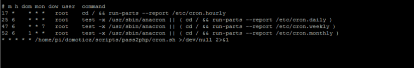

I wanted it to run with the following crontab:
2019-05-06 21_07_05-Domoticz NEW.png (42.49 KiB) Viewed 1592 times
where am I going wrong?

this means that only the cronjob is left. I havent seen a crontab looking like this, so there must be something wrong?

When I start the cron.sh file everything works. But nothing happens after 60 seconds which means the crontab is not working. The crontab looks as followingImage

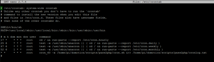

Did you see my crontab?
# m h  dom mon dow   command
* * * * * /usr/bin/nice -n20 /var/www/html/secure/cron.sh >/dev/null 2>&1
*/2 * * * * /usr/bin/nice -n20 curl -s "http://127.0.0.1/secure/cron.php?cron120" >/dev/null 2>&1
0 * * * * /usr/bin/nice -n20 curl -s "http://127.0.0.1/secure/cron.php?cron3600" >/dev/null 2>&1
0 0 * * * /usr/bin/nice -n20 curl -s "http://127.0.0.1/secure/cleandomoticzdb.php" >/dev/null 2>&1
1 0 * * * /usr/bin/nice -n20 /var/www/_SQLBackup/sqldaily.sh >dev/null 2>&1
Remove the cron_60 -x from the line.
And if you're on a Pi add >dev/null 2>&1 to have the output killed and save your SD card. The less writes you have the better.

Ok, I did so. the line now looks like this:
2019-05-07 12_20_19-Domoticz NEW.png (31.41 KiB) Viewed 1572 times
I don't get it, normally it should work but maybe it work different.
I tried sudo crontab -e and entered the same line and this seems to work.
strange! is there a difference between the two different crontabs?
also, does the crontab still work after a reboot?
thnx again!
Yes it will work after a reboot :D
