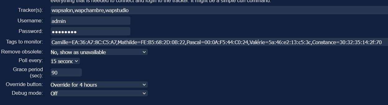

new install on a new env RPI bullseye
Domoticz Version: 2023.1 (build 15098)
Build Hash: 867c4e8fa
Compile Date: 2023-02-24 07:56:50
dzVents Version: 3.1.8
Python Version: 3.9.2 (default, Mar 12 2021, 04:06:34) [GCC 10.2.1 20210110]
When dz restart, I've got those errors
2023-02-27 00:13:23.920 ePresence: Worker thread started.
2023-02-27 00:13:32.748 Error: ePresence: wapchambre ====> SSH Could not connect (using password). Exception: No existing session
2023-02-27 00:13:42.701 ePresence: wapchambre Not (yet) ready for polling
2023-02-27 00:13:47.227 ePresence: wapsalon Could not be polled
2023-02-27 00:13:47.227 Status: ePresence: wapsalon ====> SSH resetting connection
2023-02-27 00:13:47.226 Error: ePresence: wapsalon ====> SSH failed with exception: Timeout opening channel.
2023-02-27 00:13:52.794 ePresence: wapstudio Could not be polled
2023-02-27 00:13:52.794 Status: ePresence: wapstudio ====> SSH resetting connection
2023-02-27 00:13:52.792 Error: ePresence: wapstudio ====> SSH failed with exception: Timeout opening channel.
2023-02-27 00:13:57.702 ePresence: wapchambre Not (yet) ready for polling
2023-02-27 00:14:02.352 Status: ePresence: wapsalon ====> SSH connection established
2023-02-27 00:14:07.922 Status: ePresence: wapstudio ====> SSH connection established
2023-02-27 00:14:12.703 ePresence: wapchambre Not (yet) ready for polling
2023-02-27 00:14:22.427 ePresence: wapsalon Could not be polled
2023-02-27 00:14:22.427 Status: ePresence: wapsalon ====> SSH resetting connection
2023-02-27 00:14:22.427 Error: ePresence: wapsalon ====> SSH failed with exception: Timeout opening channel.
2023-02-27 00:14:27.708 ePresence: wapchambre Not (yet) ready for polling
2023-02-27 00:14:27.986 ePresence: wapstudio Could not be polled
2023-02-27 00:14:27.985 Status: ePresence: wapstudio ====> SSH resetting connection
2023-02-27 00:14:27.983 Error: ePresence: wapstudio ====> SSH failed with exception: Timeout opening channel.
2023-02-27 00:14:37.554 Status: ePresence: wapsalon ====> SSH connection established
2023-02-27 00:14:42.709 ePresence: wapchambre Not (yet) ready for polling
2023-02-27 00:14:43.114 Status: ePresence: wapstudio ====> SSH connection established
2023-02-27 00:14:57.660 ePresence: wapsalon Could not be polled
2023-02-27 00:14:57.710 ePresence: wapchambre Not (yet) ready for polling
2023-02-27 00:14:57.660 Status: ePresence: wapsalon ====> SSH resetting connection
2023-02-27 00:14:57.659 Error: ePresence: wapsalon ====> SSH failed with exception: Timeout opening channel.
2023-02-27 00:15:03.165 ePresence: wapstudio Could not be polled
2023-02-27 00:15:03.165 Status: ePresence: wapstudio ====> SSH resetting connection
2023-02-27 00:15:03.164 Error: ePresence: wapstudio ====> SSH failed with exception: Timeout opening channel.
2023-02-27 00:15:12.711 ePresence: wapchambre Not (yet) ready for polling
2023-02-27 00:15:12.785 Status: ePresence: wapsalon ====> SSH connection established
2023-02-27 00:15:18.295 Status: ePresence: wapstudio ====> SSH connection established
2023-02-27 00:15:27.713 ePresence: wapchambre Not (yet) ready for polling
2023-02-27 00:15:32.827 ePresence: wapsalon Could not be polled
2023-02-27 00:15:32.827 Status: ePresence: wapsalon ====> SSH resetting connection
2023-02-27 00:15:32.826 Error: ePresence: wapsalon ====> SSH failed with exception: Timeout opening channel.
2023-02-27 00:15:38.360 ePresence: wapstudio Could not be polled
2023-02-27 00:15:38.360 Status: ePresence: wapstudio ====> SSH resetting connection
I disable and enable the pluging and after it's ok
2023-02-27 00:15:48.714 Status: ePresence: Stop directive received.
2023-02-27 00:15:48.908 Status: ePresence: Exiting work loop.
2023-02-27 00:15:48.914 Status: ePresence: Stopping threads.
2023-02-27 00:15:48.914 Status: ePresence: Stopped.
2023-02-27 00:15:57.779 ePresence: Worker thread started.
2023-02-27 00:15:57.779 Status: ePresence: Entering work loop.
2023-02-27 00:15:57.779 Status: ePresence: Started.
2023-02-27 00:15:57.941 Status: ePresence: Initialized version 2.1, author 'ESCape'
2023-02-27 00:15:59.268 Status: ePresence: Starting tracker:wapsalon, user:admin, class:ssh_autodetect and poll interval:15
2023-02-27 00:15:59.394 Status: ePresence: wapsalon ====> SSH connection established
2023-02-27 00:15:59.514 Status: ePresence: Starting tracker:wapchambre, user:admin, class:ssh_autodetect and poll interval:15
2023-02-27 00:15:59.748 Status: ePresence: wapchambre ====> SSH connection established
2023-02-27 00:15:59.902 Status: ePresence: Starting tracker:wapstudio, user:admin, class:ssh_autodetect and poll interval:15
2023-02-27 00:16:00.025 Status: ePresence: wapstudio ====> SSH connection established
Some config
Screenshot 2023-02-27 153232.jpg (9.77 KiB) Viewed 4242 times
Screenshot 2023-02-27 153249.jpg (58.24 KiB) Viewed 4242 times
Any idea to make it work?

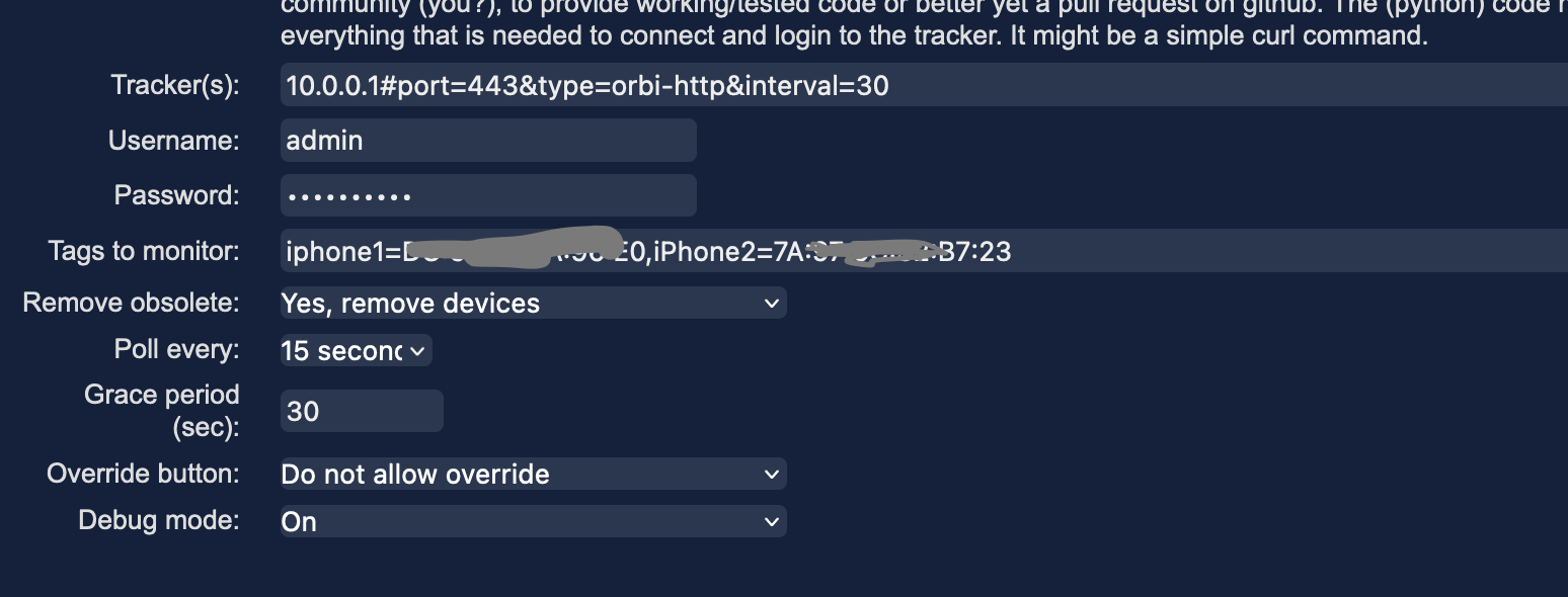

I have tried to get the plugin working on my setup. Without luck so far.
Router I want to poll is a Netgear Orbi (firmware version V4 4 1 29 3 10 80)
Running Domoticz (2022 2).
I have configured the plugin with tracker: '[local IP address]#type=orbi-http'
I am getting to following error in Domoticz log:
' Error: Home detection: [local IP address] Polling error: Failed to parse: [local IP address]:False'
Do I miss something or am I doing anything wrong?
Many thanks for any help!

Some config
I still have the same issue :-(
I need to disable the hardware and enable it again, and restart dz.

I'm trying to use iDetect with an Orbi system , but so far it is hardly failing. Would appreciate any help
Here is the setup:
Screenshot 2023-03-20 at 17.06.15.png (132.25 KiB) Viewed 4190 times
and here after are the log
Mar 20 17:04:39 rasp jemalloc.sh[30336]: 2023-03-20 17:04:39.062  iDetect: 10.0.0.1 Timed poll starting like clockwork
Mar 20 17:04:39 rasp jemalloc.sh[30336]: /usr/lib/python3.10/site-packages/urllib3/connectionpool.py:1045: InsecureRequestWarning: Unverified HTTPS request is being made to host '10.0.0.1'. Adding certificate verification is strongly advised. See: https://urllib3.readthedocs.io/en/1.26.x/advanced-usage.html#ssl-warnings
Mar 20 17:04:39 rasp jemalloc.sh[30336]:   warnings.warn(
Mar 20 17:04:39 rasp jemalloc.sh[30336]: 2023-03-20 17:04:39.345  iDetect: 10.0.0.1 Returned: <html><head>
Mar 20 17:04:39 rasp jemalloc.sh[30336]: <script>
Mar 20 17:04:39 rasp jemalloc.sh[30336]: top.location.href="multi_login.html";
Mar 20 17:04:39 rasp jemalloc.sh[30336]: </script>
Mar 20 17:04:39 rasp jemalloc.sh[30336]: </head>
Mar 20 17:04:39 rasp jemalloc.sh[30336]: <body bgcolor="#ffffff">
Mar 20 17:04:39 rasp jemalloc.sh[30336]: </body>
Mar 20 17:04:39 rasp jemalloc.sh[30336]: </html>
Mar 20 17:04:39 rasp jemalloc.sh[30336]: 2023-03-20 17:04:39.346  iDetect: 10.0.0.1 Sent RAW:<html><head>
Mar 20 17:04:39 rasp jemalloc.sh[30336]: 2023-03-20 17:04:39.346  iDetect: Inbound data from: 10.0.0.1 containing []
Mar 20 17:04:39 rasp jemalloc.sh[30336]: 2023-03-20 17:04:39.346  iDetect: 0 devices are present (excluding ignored devices)
Mar 20 17:04:41 rasp jemalloc.sh[30336]: 2023-03-20 17:04:41.075  iDetect: onHeartbeat called
Mar 20 17:04:41 rasp jemalloc.sh[30336]: 2023-03-20 17:04:41.076  iDetect: 0 devices are present (excluding ignored devices)
