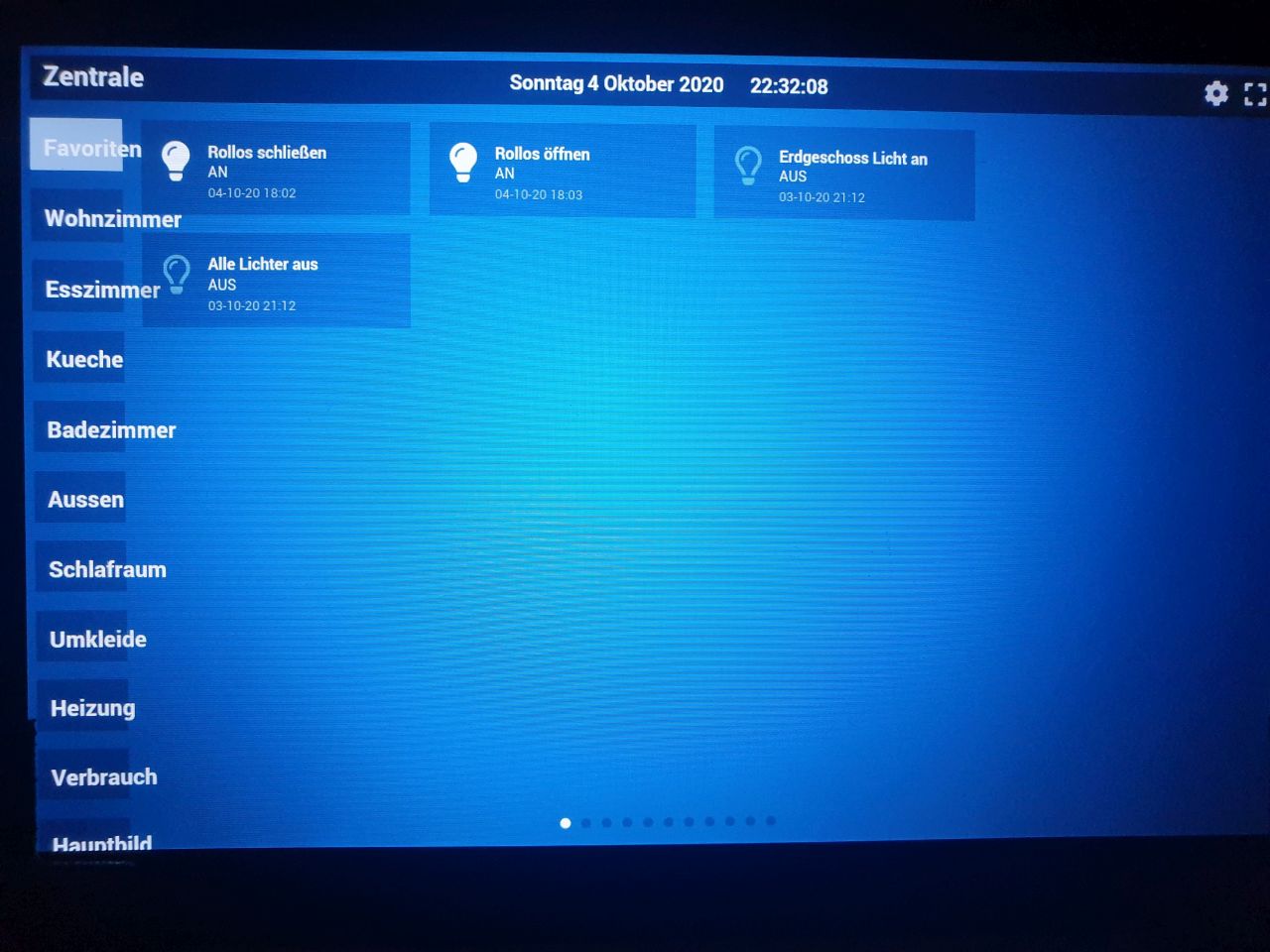

Post by DarkG »
Thank you. It worked. But is there a way to get this button to bottom in a line?
RPi4 Shelly1 Shelly2.5 ESPEasy Tuya Domoticz Beta Dashticz 3.6
Lokonli
Posts: 2296
Post by Lokonli »
Not yet...

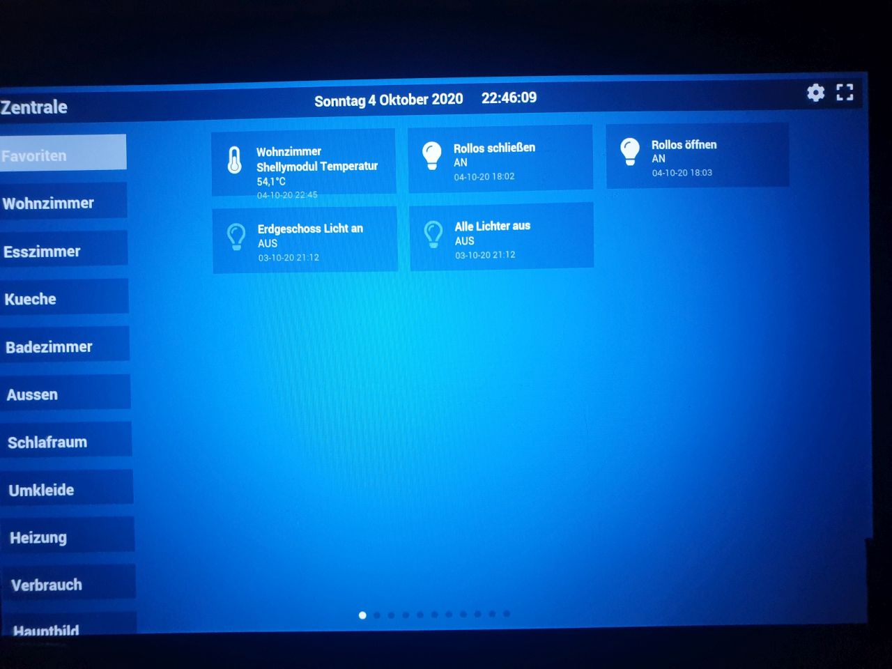

On my tablet it shows this way. How can I make the left menu bigger? So that the Text will be in it?
Width is set to 12

Lokonli
Posts: 2296
Post by Lokonli »
DarkG wrote: Sunday 04 October 2020 22:35 On my tablet it shows this way. How can I make the left menu bigger? So that the Text will be in it?
Width is set to 12
var buttons = {}
buttons.page1 = { width:12, title:'Favoriten', slide:1}
buttons.page2 = { width:12, title:'Wohnzimmer', slide:2}
buttons.page3 = { width:12, title:'Esszimmer', slide:3}
buttons.page4 = { width:12, title:'Kueche', slide:4}
buttons.page5 = { width:12, title:'Badezimmer', slide:5}
buttons.page6 = { width:12, title:'Aussen', slide:6}
buttons.page7 = { width:12, title:'Schlafraum', slide:7}
buttons.page8 = { width:12, title:'Umkleide', slide:8}
buttons.page9 = { width:12, title:'Heizung', slide:9}
buttons.page10 = { width:12, title:'Verbrauch', slide:10}
buttons.page11 = { width:12, title:'Hauptbild', slide:11}
To double the width, try:
columns['menu']['width'] = 2;
DarkG
Posts: 89
Joined: Friday 15 September 2017 18:54
Domoticz version: 4.10076
Location: Germany
Post by DarkG »
Thank you so much. It worked! Great!

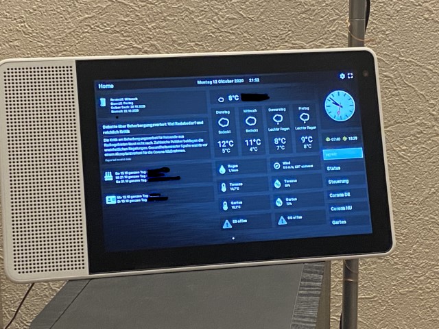

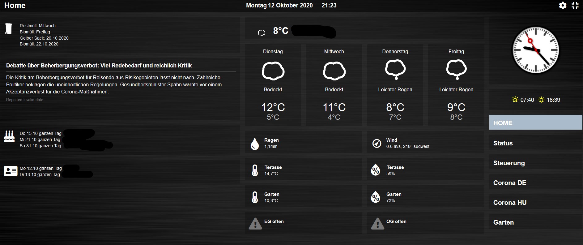

I use a 10" Lenovo Smart Display for Dashticz. It was a good deal early this year, You can still buy it for ~80€.
I cast (CATT) from my NAS, this is triggered over an IKEA motion sensor.
I tried to make a design which is readable, so I had to reduce the number of widgets on one screen.

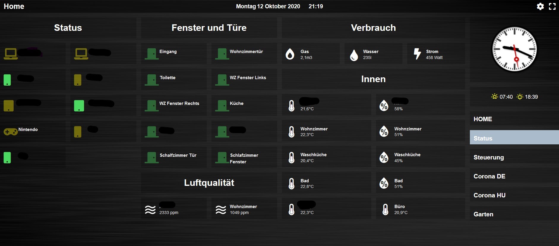

Right now the first page show the daily infos like weather, garbage, birthdays, namedays, train schedule and a warn lamp if windows are open.
For same days I have issues with the API of the local public transportation.
I call the second page as status (device status, temperatures, energy..), with the third page I can control light, irrigation...
I am updating the config files to have a nice display also on my phone too.
1_Lenovo (Klein).jpg (106.46 KiB) Viewed 5565 times
My CONFIG.js
