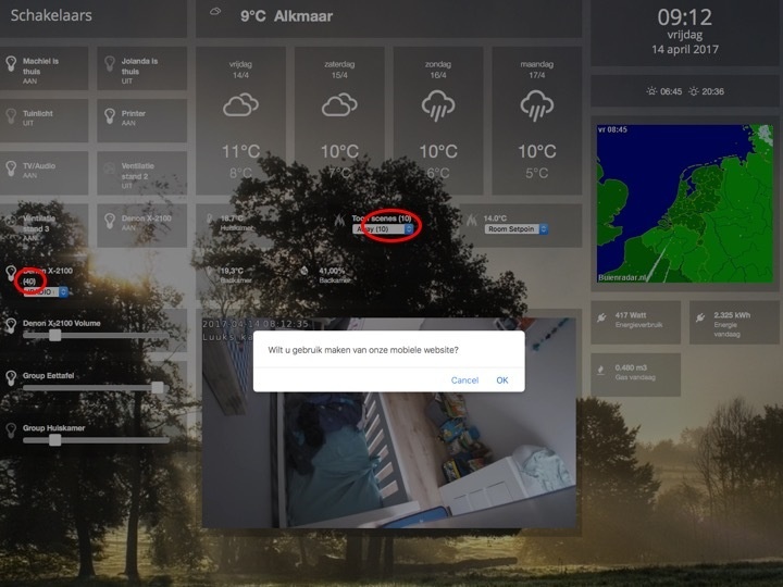

Re: New Dashboard Design v2, custom positioning and multiple screens
Posted: Friday 14 April 2017 9:21
by gielie
HansieNL wrote:gielie wrote:@HansieNL
I use the same rainscript but i dont have the switch with text, i never got this to work, can you explain how you got this to work?
Or do i just have to create a text switch with "Rain expected"? Beacause when i do that i only get "Hello world"
viewtopic.php?f=8&t=16526&start=740#p128669
Thanks for the link to this page, i still can't figure out why i can't get the text switch working with your script.
I have something else what changed with the latest update.
In the selector switch i see now the numbers of the switches like 10,20,30 (see picture), is this on purpose? And i get an popup if i want to use the mobile version with i don't understand. Can someone explain this to me?
Posted: Friday 14 April 2017 9:40
by EdwinK
gielie wrote:Can someone explain this to me
That popup is coming from the weer.nl website (I think it's in the radar). That site doesn't want to be caught in a frame. Nothing we can do about that other then either ignore it or remove the thing.
Posted: Friday 14 April 2017 9:56
by gielie
EdKo66 wrote:gielie wrote:Can someone explain this to me
OK, but i got this since the latest update, before i never had this popup and its comping back when i dismis it like every 1 minute.
