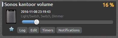

Nautilus wrote: Unfortunately can't get this working with UpdateDevice and nValue = 2. For some reason, if I use 2 as nValue the volume dimmer get's always a "Group Off" status and turns off. It does not execute the "off"-action and it does not execute the Lua script so in that sense it is ok. nValue = 1 works pretty much as you describe above. It does not update the slider but also does not trigger the Lua. I just don't understand why I was not able to make it (nValue = 0 or 1) work with my earlier experiments with another script. It only skipped the on/off actions, but still triggered the Lua for device change event. Well, maybe the conditions in Lua were not properly set...
But does it work for you with nVakue = 2? Do you have 100 step dimmer?
I use a 100 step dimmer. For that switch 0 represents Off, 1 is On, 2 is %, 3 is Group Off and 4 is Group On (didn't try it any further).
dimmer switch.jpg (15.75 KiB) Viewed 4165 times
