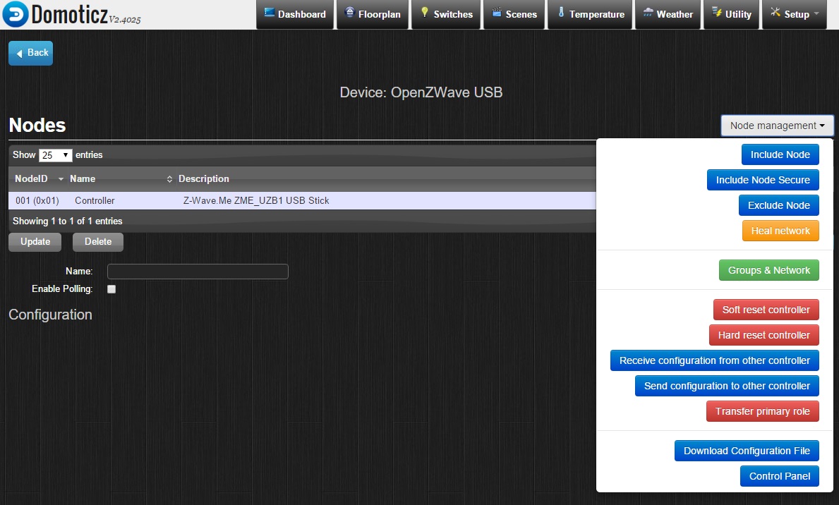

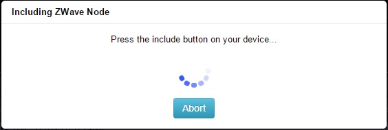

sanderl
- Posts: 21
- Joined: Tuesday 22 December 2015 19:20
Re: How to install Domoticz on a Synology NAS
Thank, you. Do you have any direction where to search/look/start?
See attached. It seems all is fine on the synology. Is it? According to http://www.vesternet.com/resources/appl ... olrWRXhC71 They are getting an "inclusion mode started...".
I only get the 2nd attachement. What does it mean? Shouild I press the button on a device i want to add or do they mean to press the button on the Open Zwave dongle (USB) which isnt there (no button).
Thanks in advance.
Thanks in advance.
