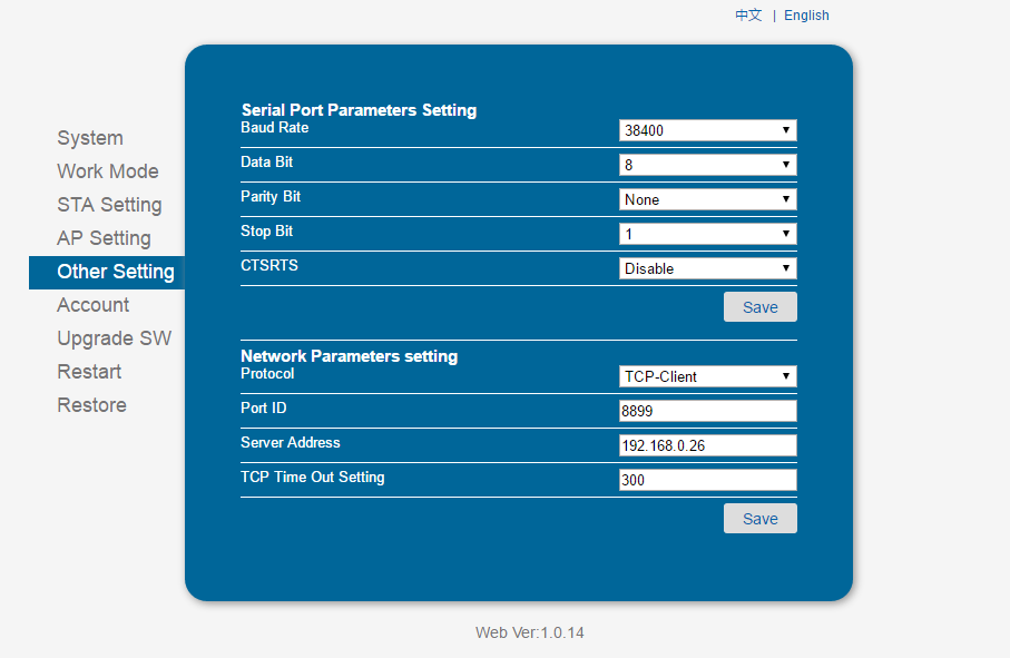

Are you using the correct IP address? Is this 192.168.0.26 what you have entered on the address bar to access the bridge management UI? In case it is, then the IP address is correct, but at least for me this IP found on "other settings" tab is different than what has been given to the bridge as the real IP address ( = the one you use to access the management page, also seen on the "system" tab). And I can see this IP is what you have entered to Domoticz.

Ok, seems it is correct then. Did you change the "server address" (IP) under "other settings" to have it same as also the real IP of the bridge? Not sure if this could have something to do with the issues. Using iBox 2 (a variant of the V6 bridge without the built-in light) is not a problem, I have two of those myself and both working just fine.
Can you specify (once more perhaps) the type of bulbs you have (when were they bought)? Have you tested also with RGBW mode and not just RGBWW?

Nautilus wrote: Ok, seems it is correct then. Did you change the "server address" (IP) under "other settings" to have it same as also the real IP of the bridge? Not sure if this could have something to do with the issues. Using iBox 2 (a variant of the V6 bridge without the built-in light) is not a problem, I have two of those myself and both working just fine.
Yes, I did change those settings. You can see it in the screenshots I've taken above.

Jarn wrote: Yes, I did change those settings. You can see it in the screenshots I've taken above.
Ok, I asked this because changing it is not needed. It can be the default and everything works so therefore I was wondering if the fact that you changed it could be the source of your issues. Not perhaps likely, but something that is different from my setup. I have there actually the "TCP-Server" option where "Server Address" field is grayed out (I assume this is the default option as I cannot remember touching it). I have set a fixed IP on the "STA Setting" tab. Here's my "Other Setting":
The real IP I have setup on STA Setting tab (the one I use in Domoticz, with port 5987) is 192.168.11.23.

Could you perhaps add a picture of all your Milight hardware (bridge, bulbs) to be sure we're on the same page there? :)
