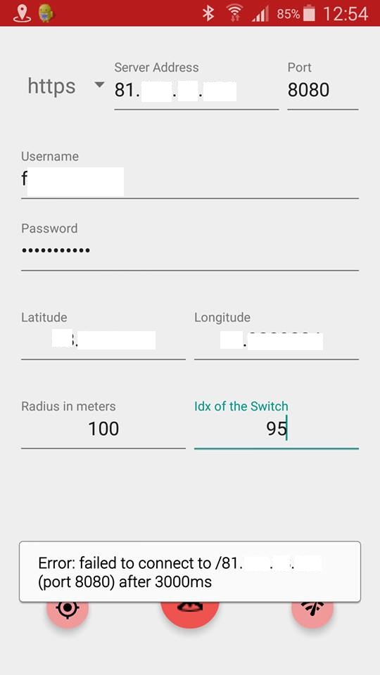

Don't work for me, not http, not https.
Testet JSON on google chrome on mobile, that works. Domoticz V2.4538

error on http alsoAppesteijn wrote:Can you try setting http ? Usually https is used with port 443 and http with 80 (or 8080)

Appesteijn wrote:Could you try with your server's internal ip (when your connected to your wifi) and then http + port 8080 and https + port 443 ?
https+443 giv the same error as in image 3 (just with https and 443 in text)

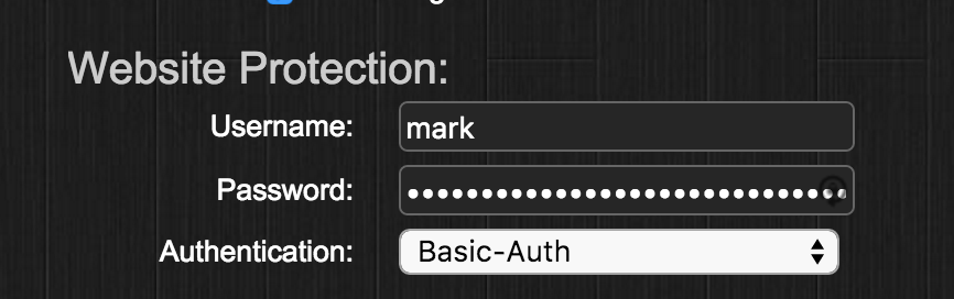

Ok I think I see what is going wrong, at your domoticz server under 'Settings', it should look like in the screenshot ("Basic-Auth"). Then http + 8080 should work. If you want httpS work you should forward a port (eg 8080) to internally 443.
- Screen Shot 2016-02-15 at 17.17.23.png (106.21 KiB) Viewed 4528 times
