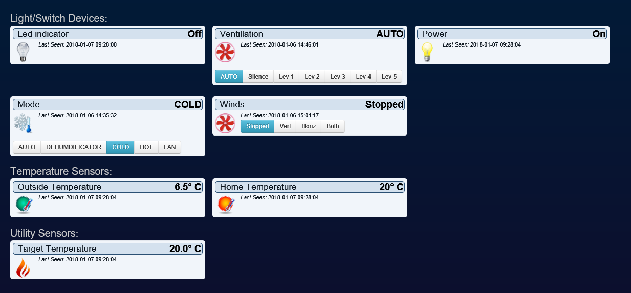

spiderjn
- Posts: 22
- Joined: Wednesday 27 December 2017 13:37
- Domoticz version: 3.8834
Re: Daikin integration
hi all, happy new year !!
i made change on hardware "daikin controler", now i can set target temperature, but i search documentation or help to inprove/finalize this module.
i post on an other threads : https://www.domoticz.com/forum/viewtopi ... 09b2dccaf5
for updated parameter you need to call with atleast 6 mandatory parameters( https://github.com/ael-code/daikin-control)
http://X.X.X.X/aircon/set_control_info? ... 8.0&shum=0
Best regards
Best regards

my pull request has been approved and commit in developpement branch.
in next beta you can see new device and new command.
Have fun.
Have fun.
