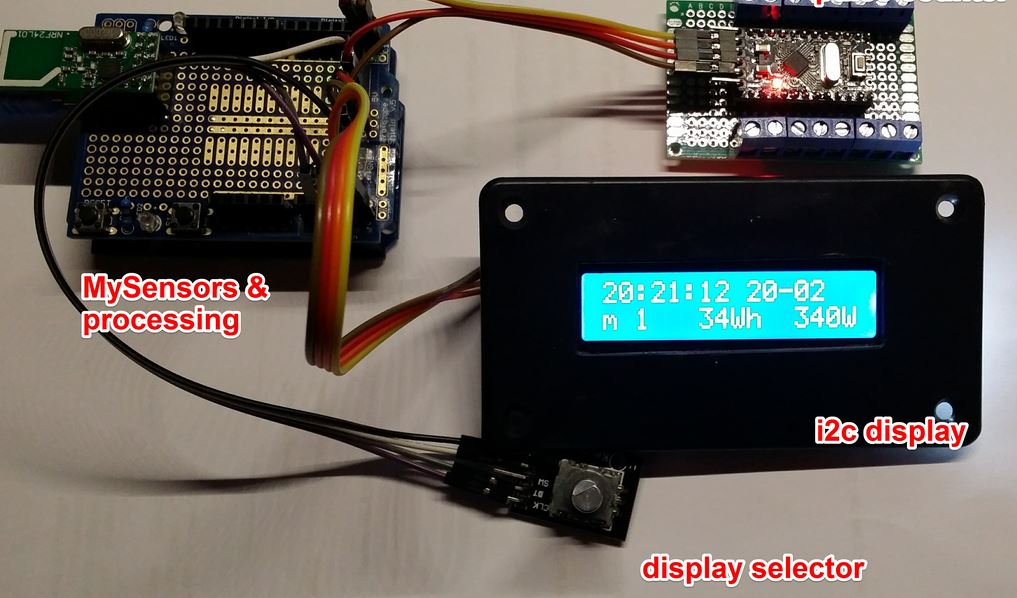

I agree that these could be used, but why maintain extra variables when the variable is present and in the right definition... The VAR types in MySensors are "Custom values" for when nothing else fits. For illustration purpose. This "display/ power sensor" currently reads the power/ temperature and other weather values from Domoticz (by means of python JSON for now :? ) through the MySensors network and displays it in every location I want.
Display
Display
