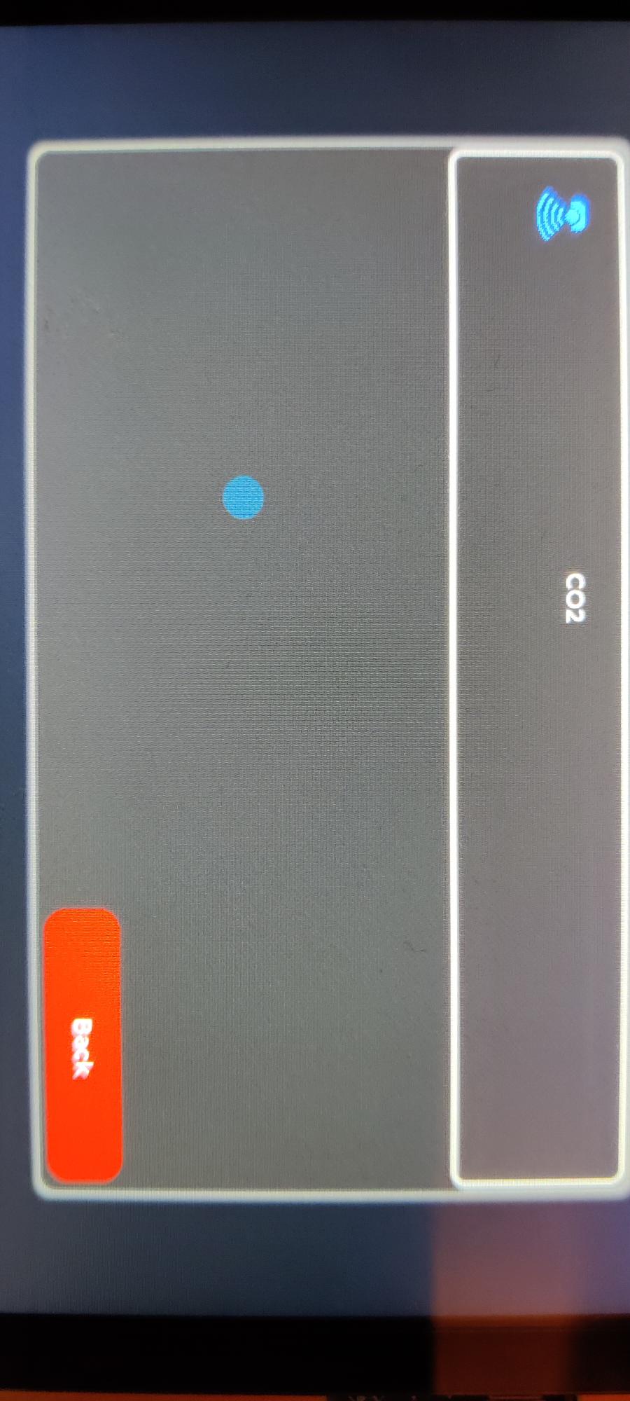

I tried also to display a temp en hum sensor on the dispay, it worked but after selecting this device the display was very slow, almost not responding on touch. After removing that device from the display (took some time) the display freezes and had to reset it with the button on the back.

I think it's because the graph, it depend of hardware processor, domoticz json (some of them can be realy hudge).I tried also to display a temp en hum sensor on the dispay, it worked but after selecting this device the display was very slow
Can you try with another sensor ? Zigbee one are working for me, else to finish trying the device first, you can comment on device_panel.cpp line 590
pTab = GetGraphValue(SelectedDevice->type, SelectedDevice->idx, &min, &max);I m checking all was fine for thoses ones, you have issue with them ?Attached some info about "Screen boven" and "Zibee plug 3".

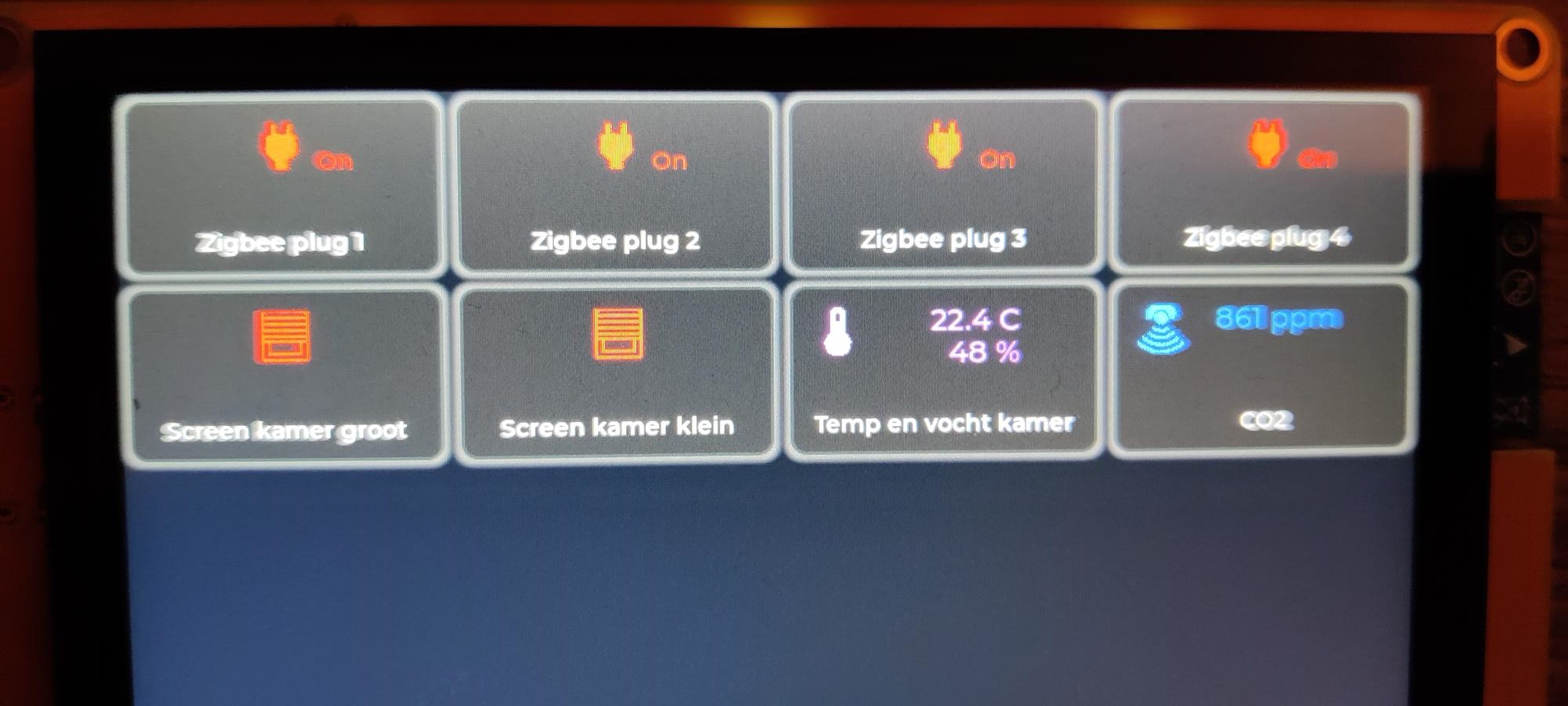

Suggestion for On/Off indication of a switch: put the text On or Off insteat of the power symbol?

For the moment I display a "on" or nothing if the device is "off" (more visible for me).
New version online in branch "test" 5 mn ago.

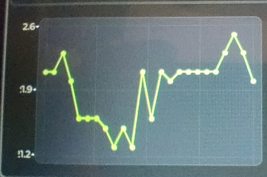

I was using 7 days, to test i changed the setting to 1 day yesterday. Domoticz was displaying 7 days in the graph. I can set de short logging in Domoticz to 3 days also. I can try this. I am not shure missing 2 days now because i changed the setting to 1 yesterday
If a graph is displayed, the numbers on the y-axis are not complete, see attachment, the temperature is betweent 20-22 degrees.

The group/scene is working for me, with a remark. If i switch a group "On", all lamps are going on, but i can't switch the group Off. I have to swipe to the Home screen and back to the group screen and then i can switch off.
Thx
- DisplayFoutY_as_1.jpg (285.53 KiB) Viewed 3436 times
Thorgal789
- Posts: 919
- Joined: Wednesday 15 August 2018 14:38
- Target OS: -
Re: New project, a small wall display to control Domoticz using CYD (Cheap ESP32 touchscreen)
Ok, so new version online in branch "Beta".
For your display issue,on device_panel.cpp
25 is for small device, have set 35 for yor device, but it's random, tell me if you need a better value.
Have set a scale of 4 value instead of 3 for graph on Y.
Have rewrited the group code.
- Different color for group and scene
- All the button is grayed for group
- Solve your issue.
#if DEVICE_SIZE == 1
lv_chart_set_axis_tick(chart, LV_CHART_AXIS_PRIMARY_Y, 3, 2, 4, 1, true, 25);
#else
lv_chart_set_axis_tick(chart, LV_CHART_AXIS_PRIMARY_Y, 3, 2, 4, 1, true, 35);
#endifHave set a scale of 4 value instead of 3 for graph on Y.
- Solve your issue.

Thx,
These changes are working for me.
I think i have 1 last question/ issue, i have a CO2 sensor that is displaying its values on the home screen, but i don't get a graph.
Thanks for your help and very quick responding
- CO2 sensor_1.jpg (316.63 KiB) Viewed 3400 times
- CO2_sensor.doc
- (17 KiB) Downloaded 181 times
- CO2 sensor_2.jpg (167.36 KiB) Viewed 3400 times

New version on branch "test".
- Have added the custom sensor
- The minimum in graph is now 0 if 0 is the lower value.
- Corrected a problem on range.
And BTW, I get data for 3 days, but I display only the last 24h, so a range on X axis is 6h.
